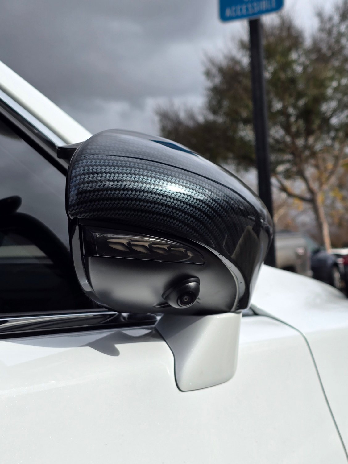

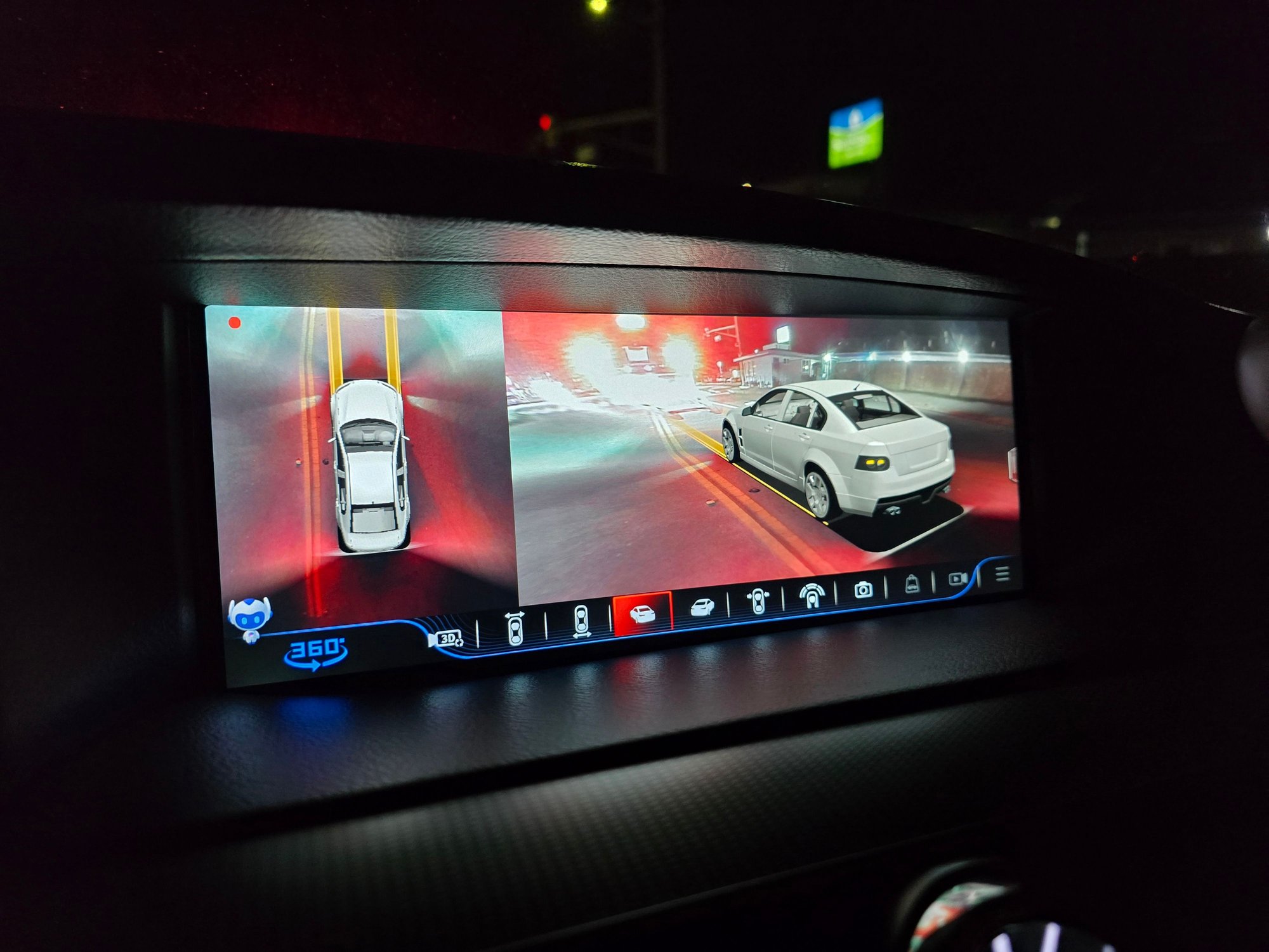

I just installed 360 cameras on my 2013 LS460 F Sport:
You need:
I just found this on AliExpress:
$1,081.60 | 12.3 Inch For Lexus LS460 600h 2013-2016 Android 13 CarPlay GPS Navi Multimedia Player Car Radio Qualcomm 668s Screen Head Unit
https://a.aliexpress.com/_mL6aWOX
And the 360 cameras:
$62.29 | 360 Bird View System AHD 1080P SONY 307 360 Degree Camera Support Night View with WDR function
https://a.aliexpress.com/_msSgsNl
