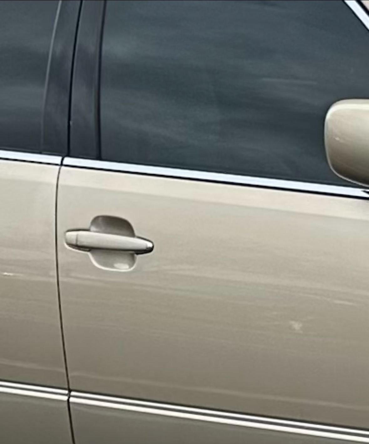

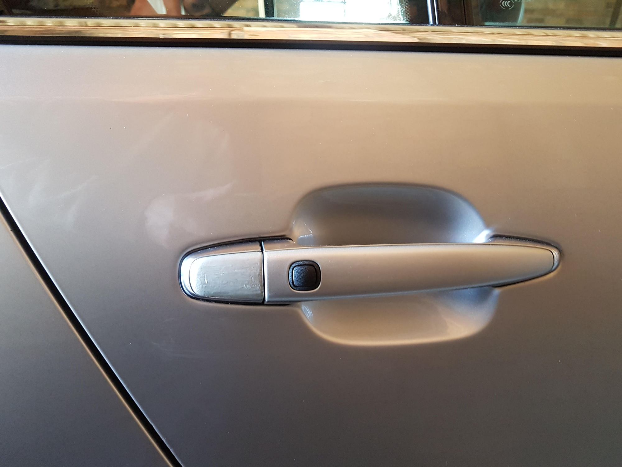

edit: here are some pics to clarify what I’m talking about. The top pic is what I want to install, the bottom is what I currently have.
Hey guys, thanks for taking the time on helping me or just here to read along. My general understanding is that the pre-facelift (01-03) never came with keyless entry in North America for some reason, while jdm and euro specs did! I am extremely furious my UL 2001 doesn't have it lol. I know someone personally in the UK who has it on their 01' and he was surprised that the American spec LS' didn't come with it. Does anyone know why it didn't come equipped with it? And if possible, what is required to retrofit it?? I understand I would need the door handles with the buttons, the key, new keyless ignition, and sorts of other computers. Would I need an ecu that is compatible, or would mine already be? Thanks, if anyone can shed some light it'd be much appreciated!
