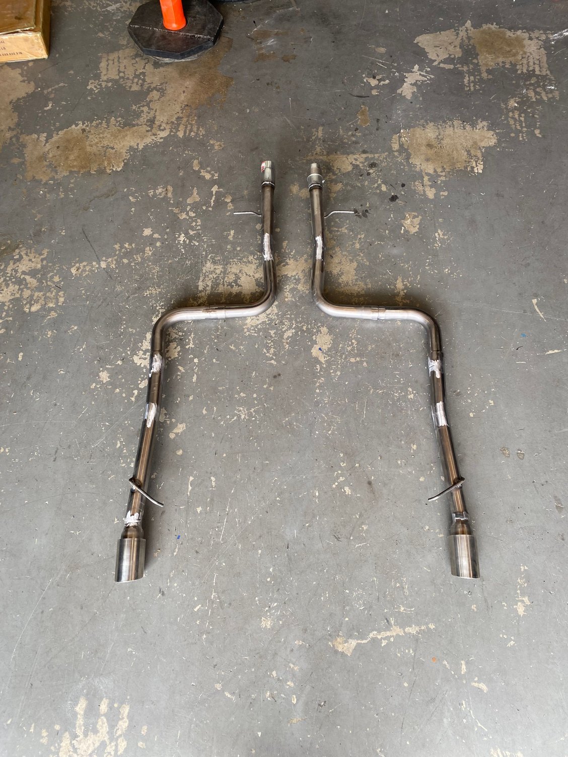

Made my own muffler deletes

Kind of a PITA to keep everything symmetrical with no real prior experience. Much quieter than expected and no noticeable drone. Just a nice low, mellow tone under acceleration. Overall happy with it.

looks clean, did you weld it up while it was on the car?
Tacked it while on the car, fully welded off the car
Originally Posted by AVSRacing
Could you just take off the mufflers lol, I was tempted to do that as my bumper doesn't have exhaust cut outs anyways. My tips point down
Nope. The exhaust after the resonators point straight to the axle boots, you’d burn them off immediately. And you’d need the hangers right after the resonators to hold the exhaust from bouncing everywhere. And I imagine that would drone like crazy.

The first set of hangers are about a foot after the resonators. I guess you could just get a foot of pipe for support and attach turn-downs or maybe a 45 degree to angle it away. But you would definitely need something.
