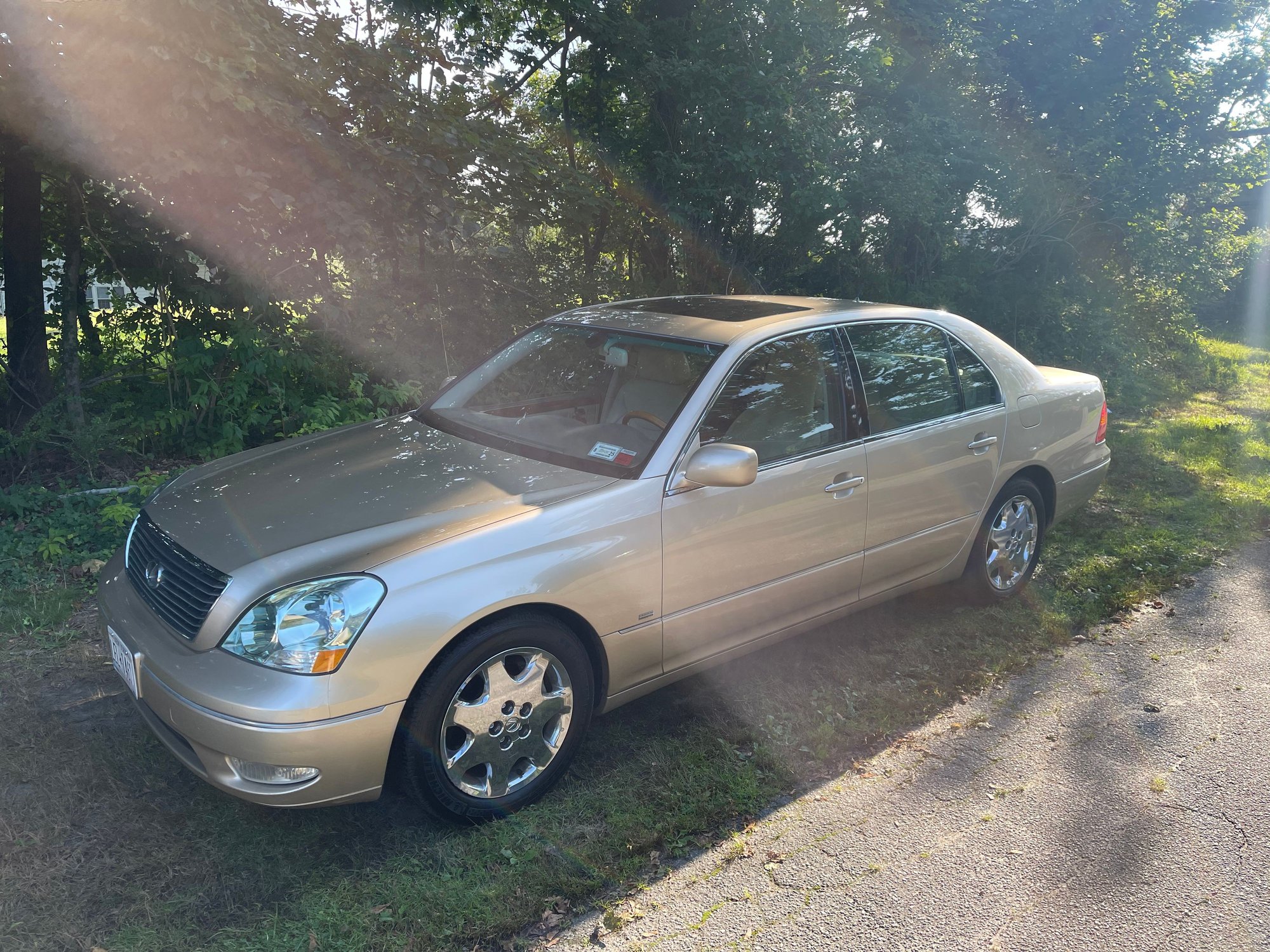

Hi,
I recently purchased a 2001 that happened to have the sport package badging. Absolutely love the car but find the car rides a bit harsh over crappier roads that my 1995 LS400 just kind of floats over. (On smooth highway pavement the 2001 has the clear advantage and it corners like a demon when called on to do so.) I kind of glossed over the sport package when purchasing because I was laser focused on maintenance history, lesson learned. The car was meticulously maintained by a single owner over 22 years. All major maintenance done including recent timing, valve cover gaskets, knock sensors radiator, alternator, suspension components, you name it. So I’m trying to figure out a way to keep it rather than just give up and resell it. Do you think there’s a way to replace any suspension components to give it a more forgiving ride? Or would that just be a stupid endeavor and I should eventually resell the car to someone seeking out this type of ride? Thank you in advance.
