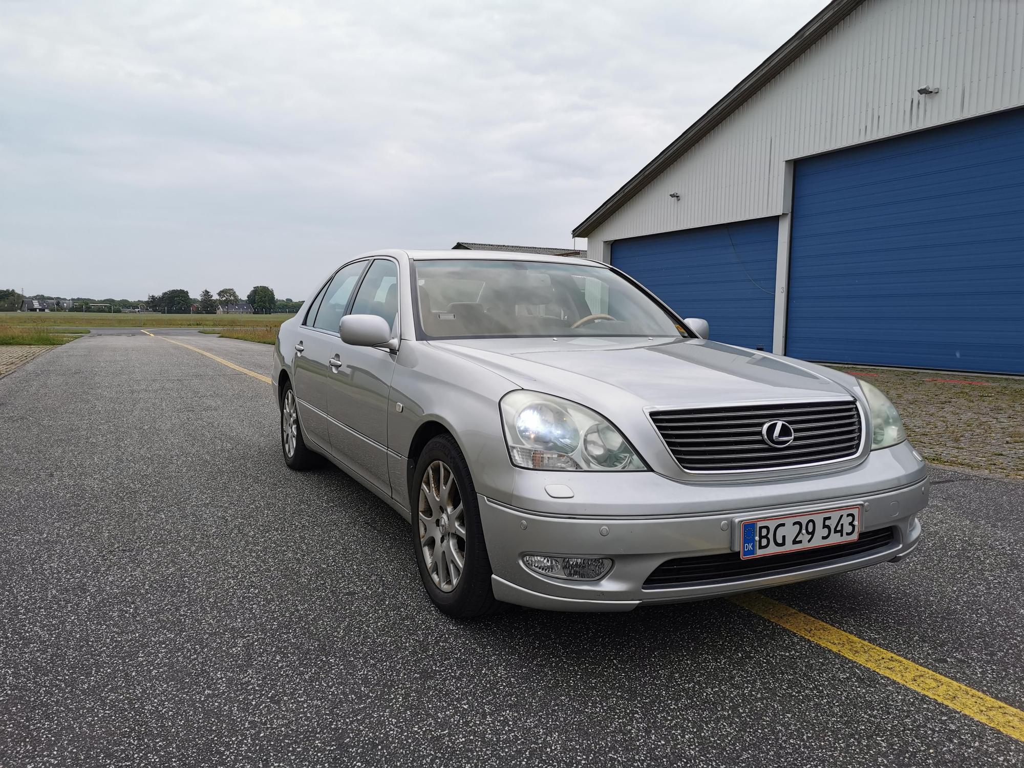

I got interested in a currently for sale pre-facelift LS430 2001 model with 143k miles.
I’ve been reading up a lot on the LS430, which was the primary cause for choosing this specific model, as I believe it will serve my needs. I want a nice, soft and quiet ride for relaxing cruising.
I’ve attached some images of the beauty.
