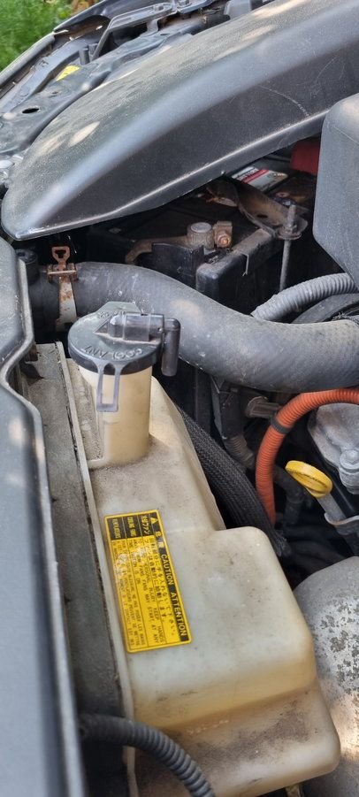

Default Coolant leakage
Since last year I discovered on my holiday adress that my coolant level was too low (normal, not the inverter one). I went to the Lexus dealer and they filled the coolant back to the normal level (100 -150ml) and I only had to pay the 1liter coolant.
This is now a year ago and during the year I keptbon filling. Also bought an additional botlle, so I think I filled in total almost 2 liters coolant dutring the year.
I want to solve this, but I am a bit scared to bring it to the local maintenance shop. I see no visual leakage at all around the radiator, but in this forum I almost always see that this is the case. The radiator is never replaced and the car is from 2005 (RX400h) with 175.000 km.
Oil is OK, no sludge or whatever. Also no white smoke when waiting at the trafic lights. So I don't think it dissapears in the motor.
The waterpump was replaced somewhere in 2017.
Below also a picture on the cap of the coolant. There is a outlet and I am wondering if it is missing the hose?
Is there a way I can check what is the cause of the leakage?

Old Jun 5, 2023 | 05:52 PM
thomas1's Avatar
thomas1
Joined: Sep 2006
Posts: 3,054
Likes: 103
From: Sacramento, California
The coolent cap on my doesnt have a hose either. I possibly found another area of leakage just left of the oil filter on the block. There is a inspection plate held on wih two nuts on studs. Mine has antifreeze residue below that plate. On my old RX300 there is also a bypass hose under the intake manifold. I assume this 3.3 engine also has that. The fluid was leaking in the lower intake manifold gasket. which goes to both heads. That one was hard to see, but basically residue that had dried was on the engine block on the driver side of the engine (left side of car). when my radiators leaked it showed residue on the bottom frame under the radiator. As others have said if the oil is contaminated with antifreeze, than a head gasket is leaking. Because the catalytic converter runs so hot you may not see any water smoke in the exhaust.
