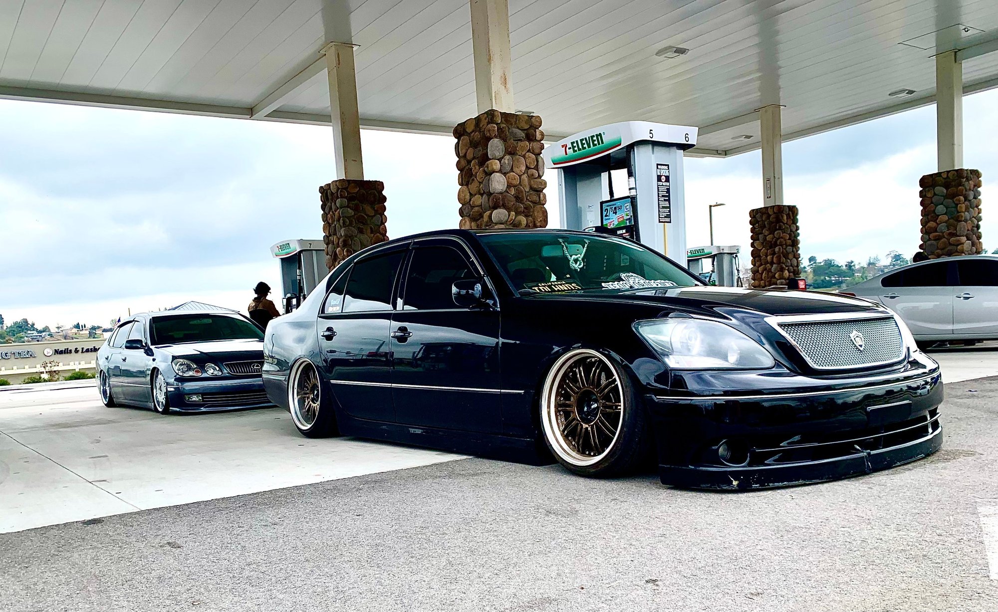

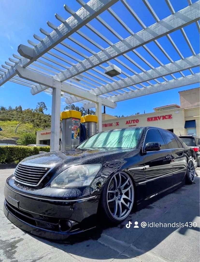

So here’s a few things…
1:Unless your wheels are high disc clearance in the front, you most likely will not clear the brake caliper..
2: You can’t roll the fenders. You have to shave the inner lip the. Use a fuller to pull them. If you attempt to roll them without doing this, you will get buckle spots in your fenders and quarters.
3: Flush fitment depends on wheel width and offset and backspacing. I had a set of Work Kiwami reps (Gross) on my ‘04 when I first got it from the previous owner. They were 19x9.5 +22 Offset squared with a high disc clearance. They sat pretty flush (Needed a cheapo spacer you get from AutoZone in the rear to be flush). The wheels I’m running now are SSR Professor VF1 with a staggered width. 19x9.5 +12 offset High Disc and 19x10.5 +18 Super Low Disc. These fit flush with no spacers. I will include pics

I assume your fenders are rolled? What suspension are you on?

Can’t fender roll these. They will
buckle. You have to shave the inner lip.
