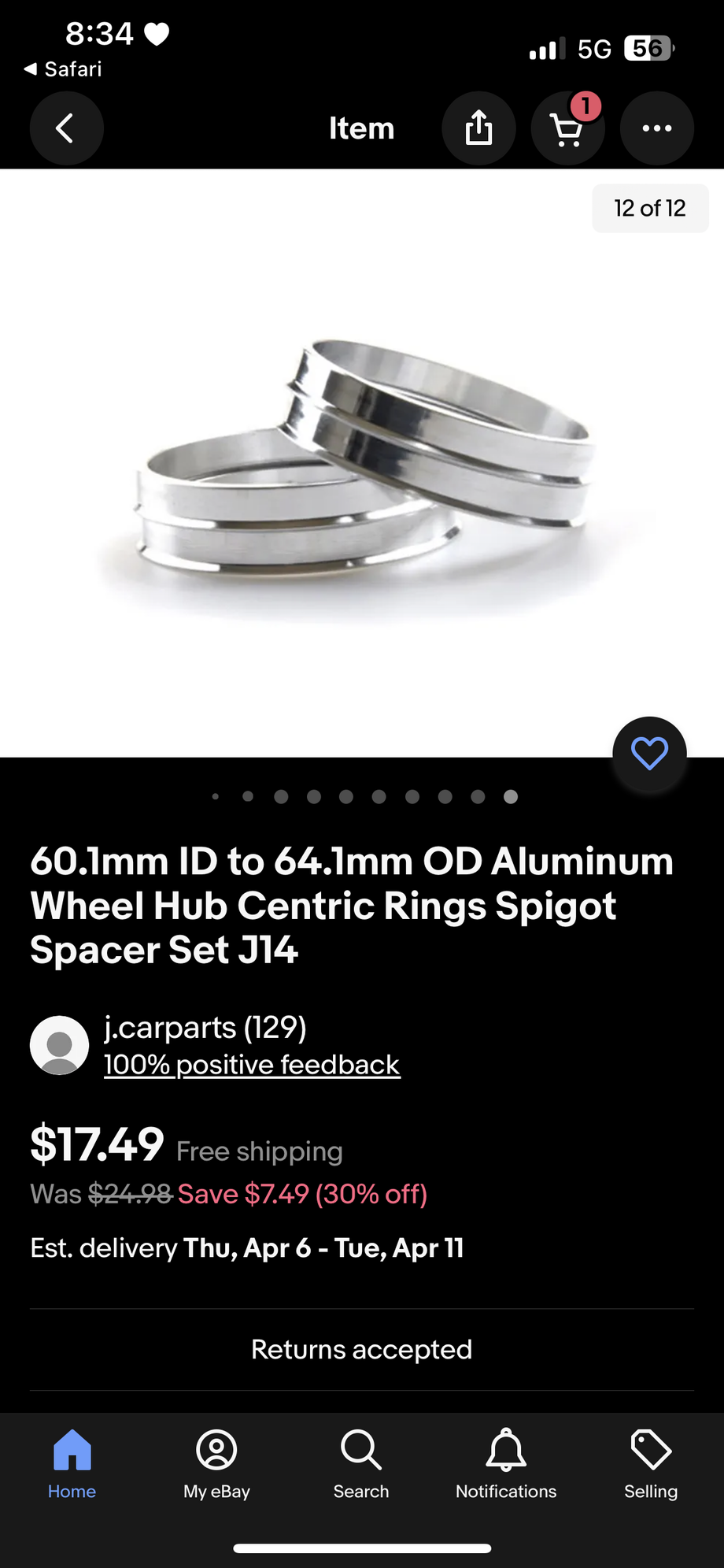

additionally will these hub rings work as the ones linked have a 1-2month delivery estimate, thank you

Why Doe? So much work and money just to get TL wheels with the wrong size tires. You need spacers for sure to clear the brakes, from what I remember Honda and Toyota have different hub sizes, also yes you must get it hub centric or else you will have vibrations. So yea not worth the hassle for the wrong wheels. At least get a set of Toyota or Lexus wheels cuz at least hub size the same, all you need is spacers to clear the brakes.
