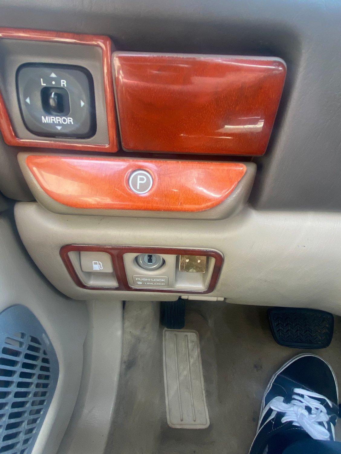

Got this 1998 LS400 a while back, noticed it had a missing tab/ button here just wondering if anyone might know which tab should be there so I can get one ordered, thanks!
Tab on the right of the push lock and unlock key

The trunk release lever (cover?) is missing. It's only serviced as a complete switch, if the parts diagram is correct.

I would suspect that the cover may be adaptable from other Toyota product at the pull yards.

it's the trunk release switch, which do tend to crack over time!
more:
https://www.clublexus.com/forums/ls-...ly-repair.html
Originally Posted by YODAONE
Frontside of original switch housing assembly. Slight crack in plastic fuel door lever which was caught in time to epoxy. If purchasing a used assembly, be sure the levers are not cracked.
