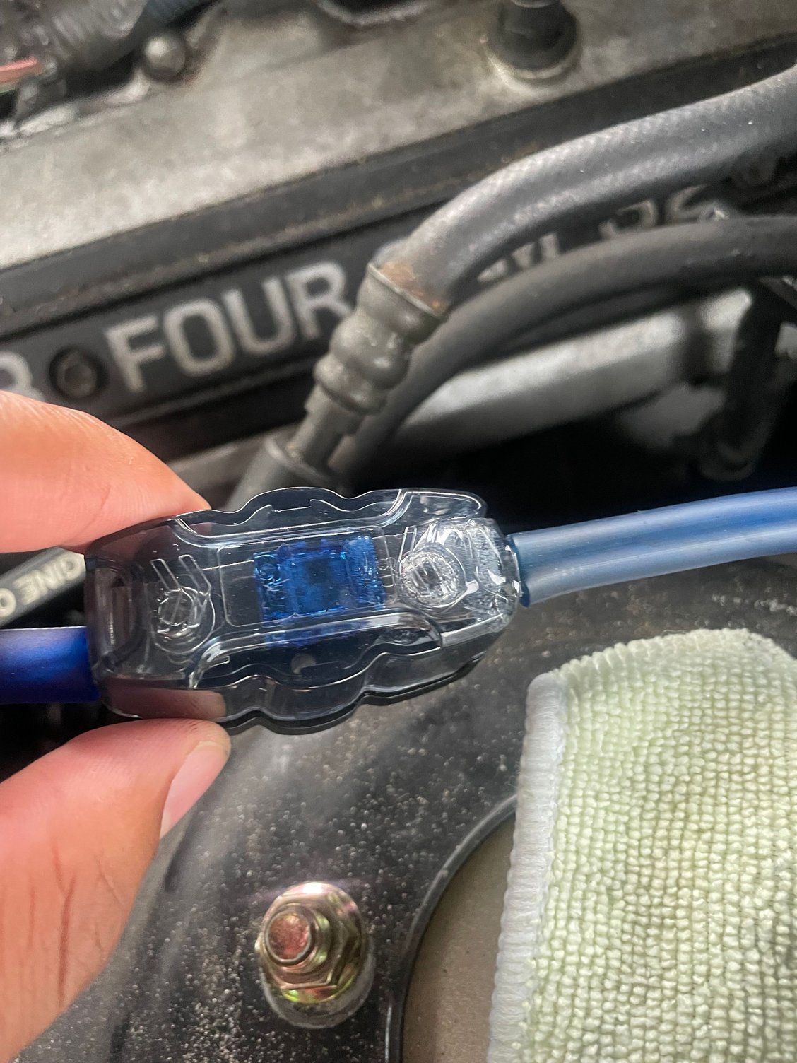

Im still new to car audio so im sorry man.... I what I believe to be a fuse hooked up to the lines coming from my battery to the amp (ill post a photo of the old one that was replaced due it melting or something) . I also have a Audiocontrol matrix plus hooked up in my trunk by the amp and my sub.
Have you considered a 130A alternator from a 2001-2003 LS430 (plug and play)?
I was looking into this after some googling and I think i may have to go this route along with a upgraded battery.
Were negative battery and engine ground cables upgraded? / Was alternator cable upgraded? Not that I know of....
