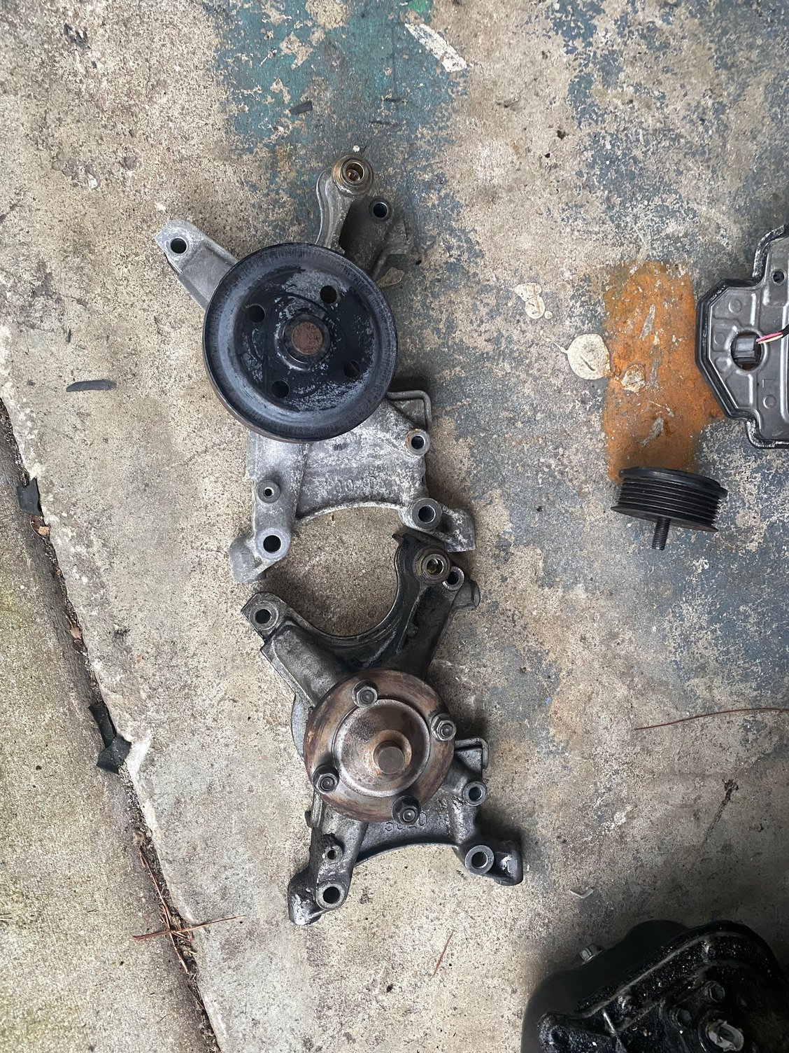

- the fan bracket needs to be swapped. JDM has only a belt driven pulley with holes. USDM uses a studded pulley that the fan bolts to with a sheath type cover sandwiched in for the belt to ride on
JDM top - USDM bottom

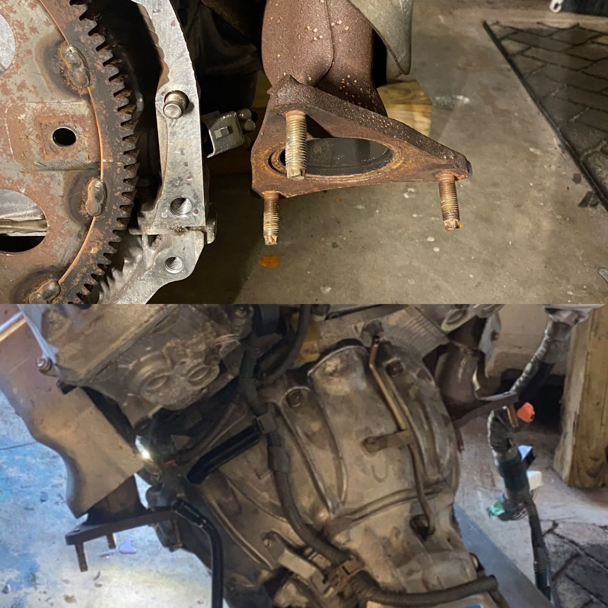

- exhaust manifold flanges are different. i’m not sure if the catalytic convertors can just be 180°’d here, but the flanges on the JDM motor were not in the same orientation as my USDM. so those got swapped over
JDM cast manifold top - USDM bottom flange different orientations!

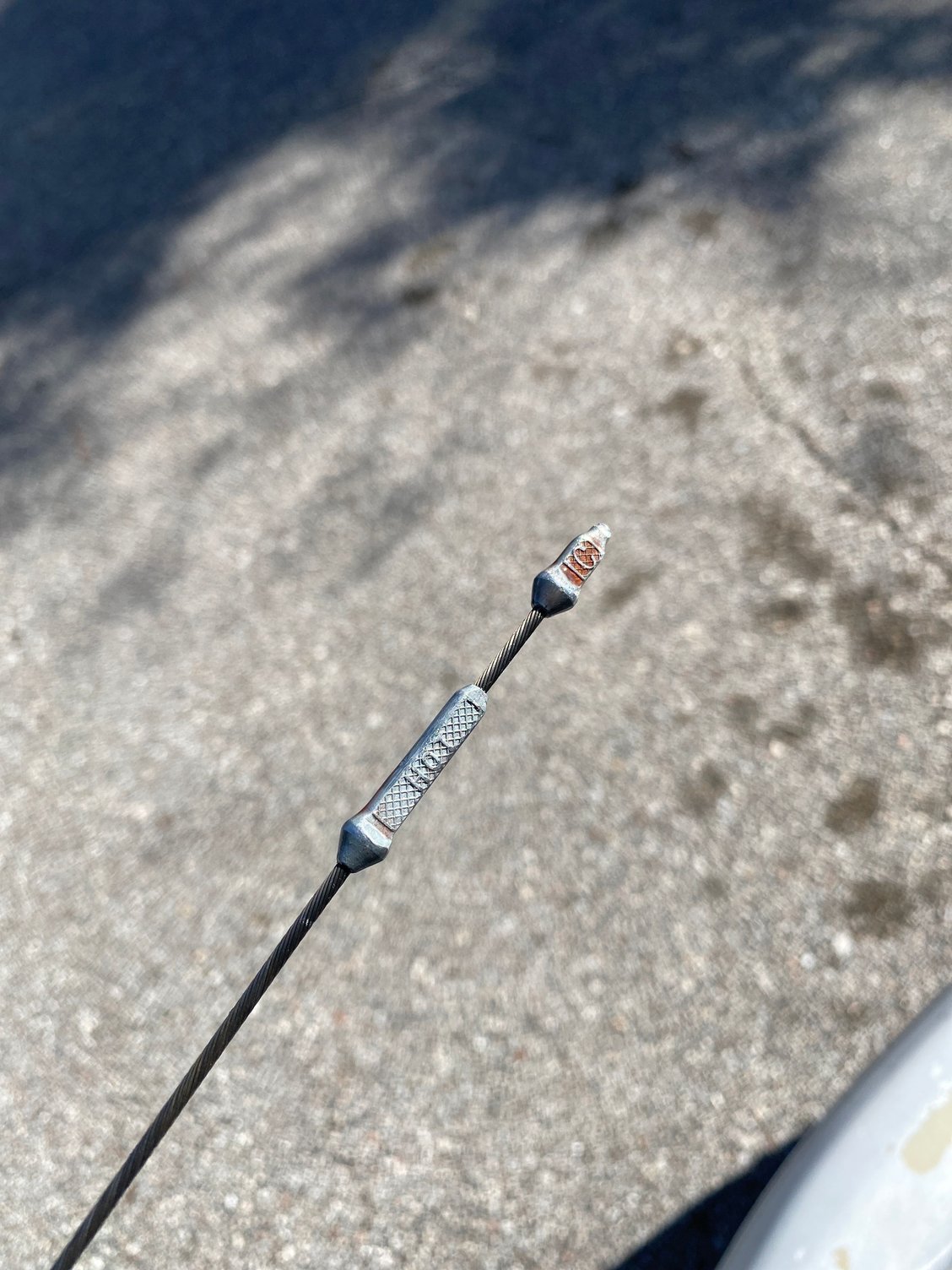

issue SOLVED - forgot the basics of high school auto mechanics class - ALWAYS check trans fluid with the car running.
I was afraid to overfill, but was checking while car off and warmed up. it was too high, so i drained some out.
justtt checked while running after suggested here….it was just barely touching the dipstick. put my last quart in, got it up to the photo and its already better. Going to park it till the rest of the fluid i need gets delivered 👍
still need more but im sure this was this issue
