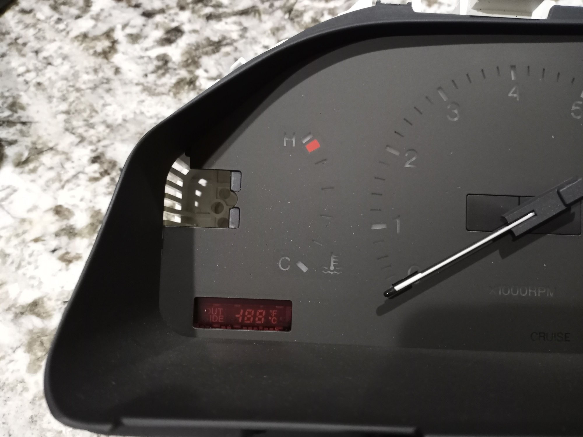

You're welcome. Here is a picture of the donor cluster with the temp guage removed. You will have to access it from the back of the cluster. Be careful with the needles, they are extremely sensitive.

Just a quick progress update, a sad update. I got the gauge cluster from my parts car out and took it apart and finally, after all those screws, I got the temp gauge removed. The one in my good car must be broken cuz there's no way the needle should go into the 8 o'clock position, it shouldn't go past the 5 o'clock spot. There's 2 stops located way up under the needle which stop it at C and H. So, here's the sad update; As I had everything laid out on my table, I get up for some coffee, I turn around and my cat was on the table. She got scared and ran, screws flying everywhere and she knocked the gauge to the floor which snapped the needle off and broke the plastic case for the gauge itself. (Yes, she's still alive ) Now I'm just gonna switch the whole cluster with the one I have with 189K. I'll know what the difference is and I don't plan on ever selling this anyway. Plus the other one has a sticker saying it was rebuilt in '04.
