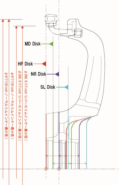

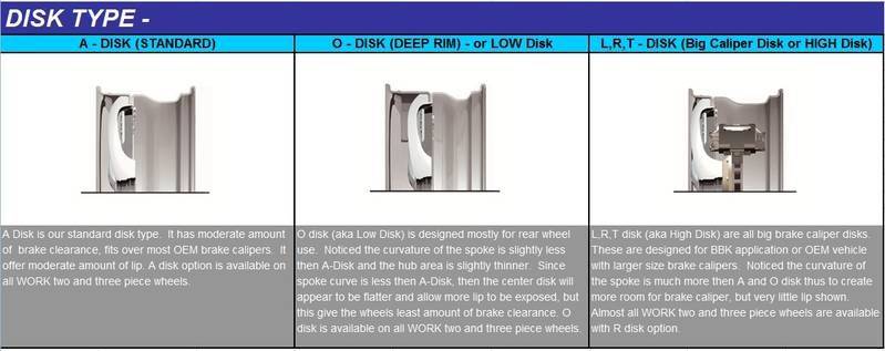

offset is only part of the equation for caliper clearance. from the looks of it the wheels should clear based on the spoke design.
it's really the pad or disk that matters.
here is how work wheels does their disk type
this is how SSR does theirs
