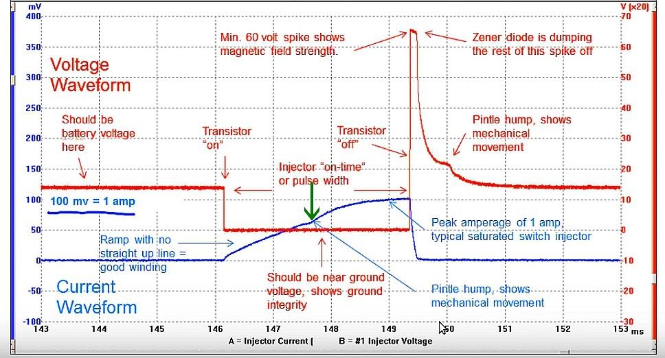

Originally Posted by python
is there any way to check for a bad fuel injector?
I am an electronics guy and the method to check injectors is totally different from the way usually done by most of mechanics or mechanical engineers. This doesn't need to remove injectors from the engine because the check is done electrically just using an oscilloscope with a current prove and a voltage probe. People say, "It's very strange and we don't understand what you do and what you explains". So this is not for everyone but if you are interested in, I will show you how to do it. The chart below is the waveforms for the judgment.
This method can tell that injectors are working OK or not if the problem is caused by the moving slider inside or the bad coil of the injector. The key point is the green arrow at the centre of the drawing. Unfortunately, this method can't tell that the problem is caused by the clogging at the gate.
