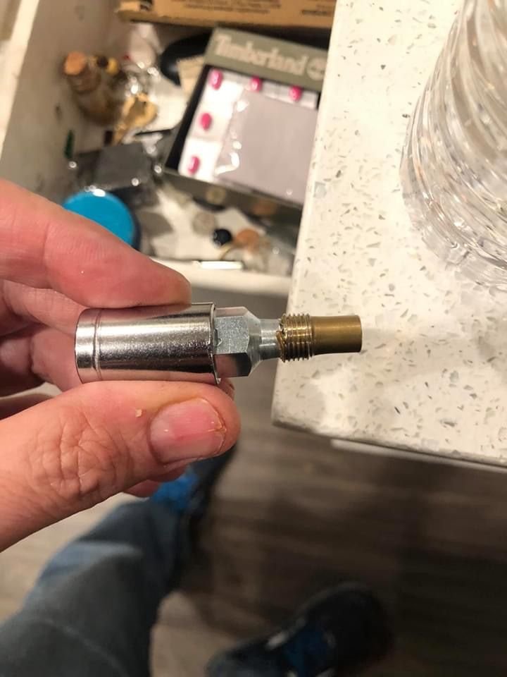

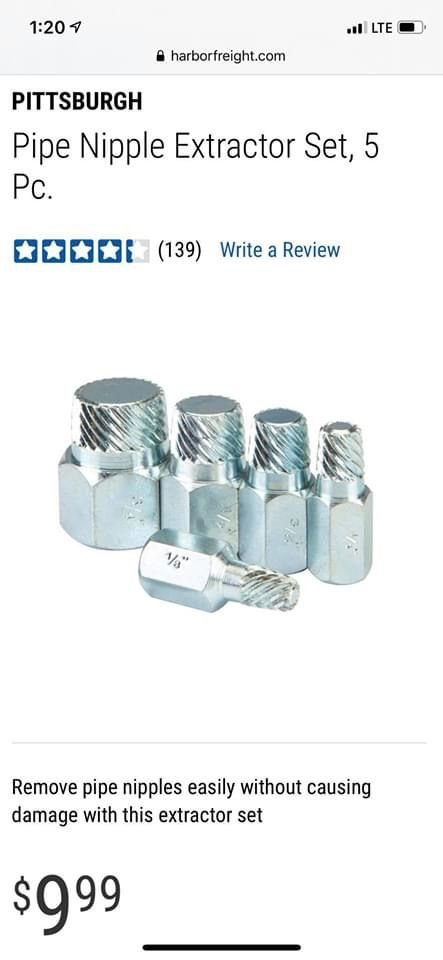

If you ever break the coolant temperature sensor, the fix is easy. Use the 1/8 inch pipe extractor with a 3/8, 1/2 inch socket (tape to the extractor ) and a /3/8 ratchet and extension. This works amazing, just push in and loosen out, its easy and you save the threads. Next time use a 1/4 socket set up and don’t over tighten. 😂. Mine was in there tight and this works perfect. I hope this helps someone in the future
