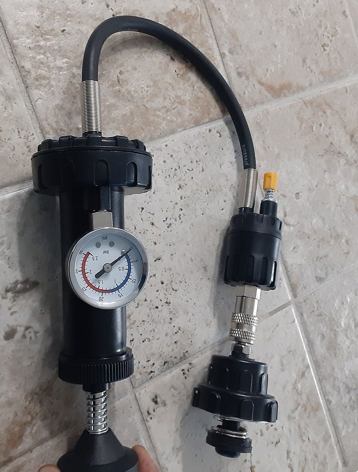

A cooling system pressure test may be useful here to find the leak. If the coolant is already drained. You can relatively easily refill it with water during testing while you hunt down the leak.

This little gem is one of my favorite Harbor Freight tools for those hard to find coolant leaks as others have posted will find the leak fast.
