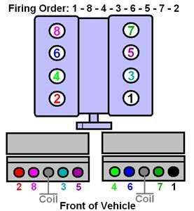

You mentioned in the first post one entire bank was gone. How did you determine that?
Cylinders 4 and 6 are in the same bank AND also both fed by the same distributor.
if you haven't already seen this it may help...

I had 5 codes at that time, cylinder 2 4 6 and 8 and also a random misfire code, the engine felt stalling especially when idling, it felt the same way this time, although I just had one code from cylinder 6.
From the diagram, cylinder 2 8 and 4 6 are fed by the different distributor? So it might not be the faulty distributor, since the chance of both went down is rather slim
