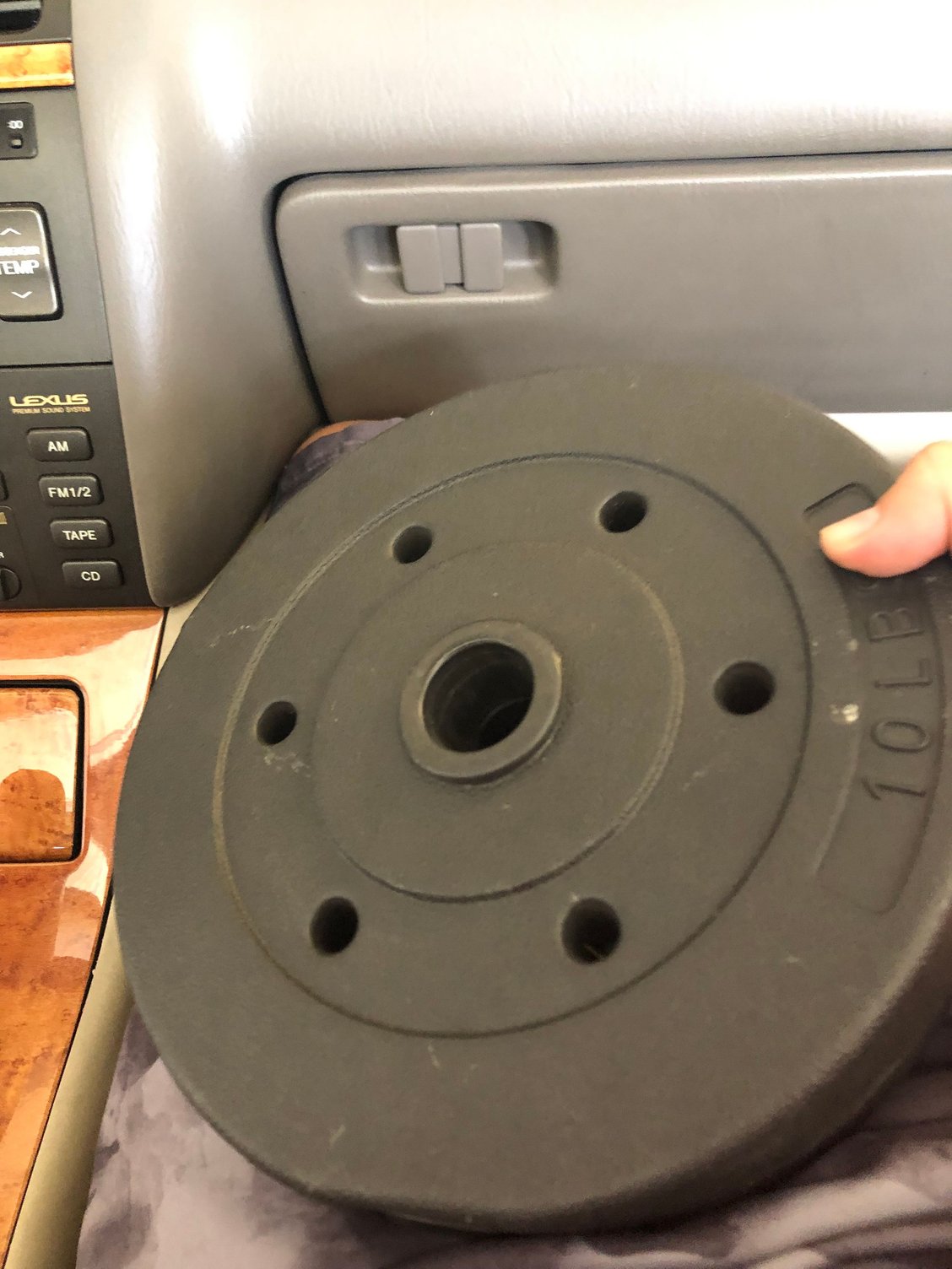

Okay guys.... sorry for not posting, so I was able to fix my old assembly and get all the glass out of the “track” which was preventing the roof from working..... the motor to the new LS roof wasn’t working.... but the older one did.... weird.... but anyways the sunroof is now fully operational, what I was able to do is grab weights (see pic) and push on the roof and evenly distribute Weight and push it back into place, all the major dents are gone but still some little ripples.... I put everything back together and had someone spray the car with water at the car wash and no leaks.... once it rains bad will see if it leaks then, but for now it’s a success! Might add some silicone to fill the little gap on the back.
You can see where I pushed the weights here.
Professional body man, using the weights. Gotta do what ya gotta do in situations like this. Everything becomes a special tool. I would fill in the little gaps with silicone just to make sure it doesn't leak in the future. Maybe silicone all the way around just because the roof was so bad. Nice work.
