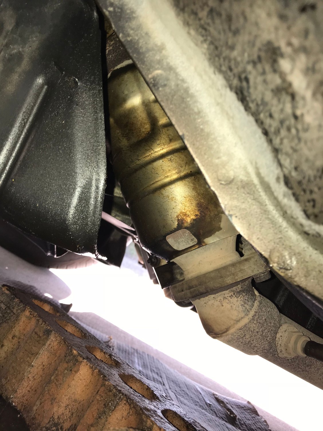

When you step outside the car you can feel the heat, and sometimes see the smoke, I was able to see where it was coming from, anyone know what this is?

Year of LS? How many miles? Does it drip oil on the floor? How is the brake fluid level? That lower cover is pretty saturated with fluid
Initial thoughts:
Valve cover gasket is allowing oil to run down and onto the exhaust.
Brake master cylinder-reservoir is leaking and this is brake fluid.

1999, 300K. Yes it drips oil, the valve cover thing was also mentioned by my father, im gonna have it proffesionally looked at, thanks for input, I’ll come back when I hear what the Lexus tech says

oil and brake fluid smell different so it should be easy to tell what it is.
