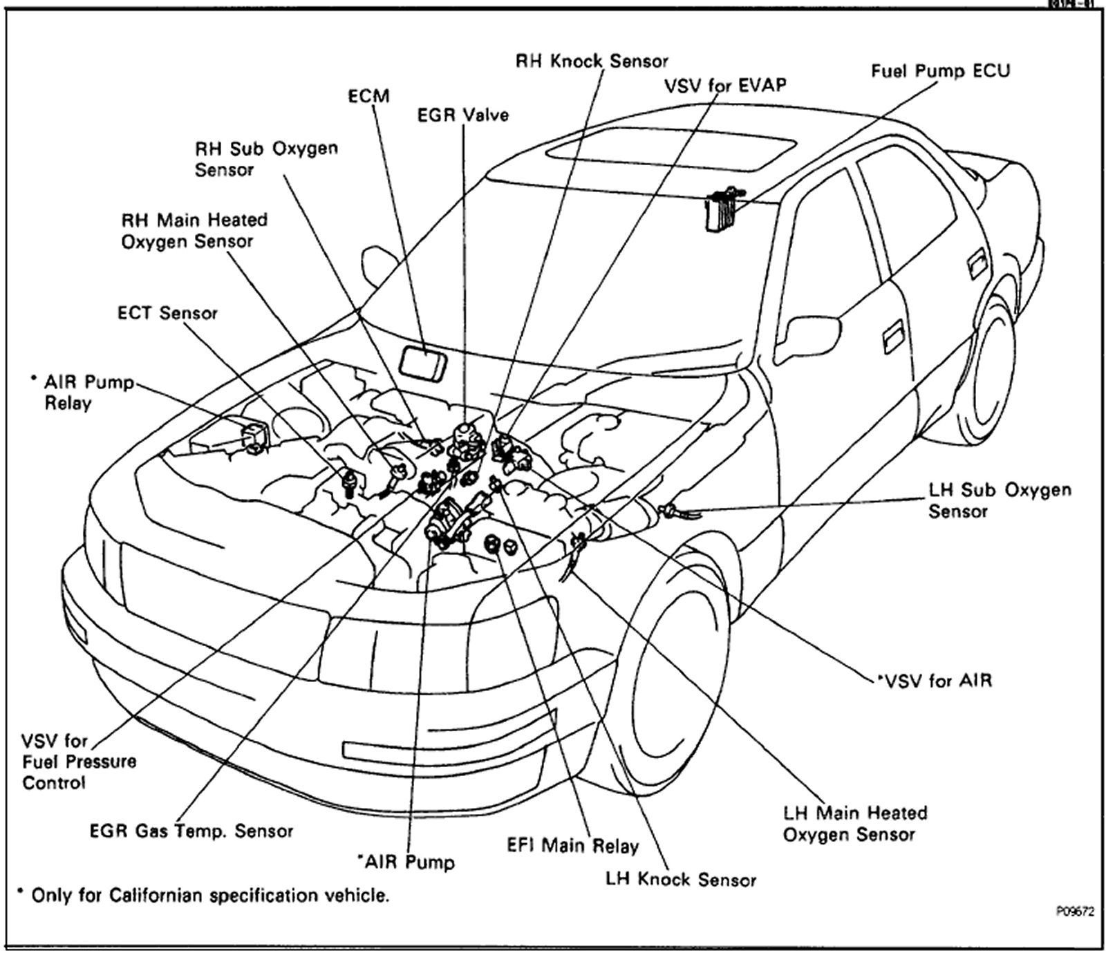

There is a single wire coolant sensor next to the ECT that goes to the gauge. I'm not having luck finding the diagram at Sewell's site, maybe another member can chime in.

how is this, they are right beside each other, up front

I can pull up a pictrure...

did you see it??

Thanks Billy-
Your pic shows it but the single wire sensor location but the parts diagram doesn't show it. One of the ECT threads has a part# for the sensor I'm thinking but I don't know what it is actually called. The sensor is about $25 my memory recalls.
Your car is probably at proper temp but because the gauge sensor is going south it indicates a false reading.
