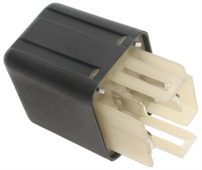

[QUOTE=whokidd;8153772] Actually there is a replacement resister for the LS400. I get all my parts from http://www.carparts.com/. They have great prices and fast service and most of the parts are direct fit.
AC Delco Relay 1996 Lexus LS400
1996 Lexus LS400 Base 8 Cyl 4.0L
AC Delco Relay-Blower motor relay
Part Number: E1749A$21.06
  • Type:
    Blower motor relay
  • Condition:
    New
  • Product Fit:
    Direct Fit
  • Quantity Sold:
    Sold Individually
  • Recommended Use:
    OE Replacement
  • Anticipated Ship Out Time:
    1-2 Business Days
  • Replaces O E Number:
    89057593
  • Terminal Quantity:
  • Terminal Type:
    Blade
  • Part Number:
    E1749A
  • Availability:
    In Stock
  • FitNote
    Oe No. 90987-04002
AC DELCO – OE REPLACEMENT BLOWER MOTOR RELAYS
The factory-original fit and lasting function of AC Delco’s OE replacement blower motor relays provide the perfect repair without breaking your budget. Established in 1899, AC Delco manufactures original GM parts and premium OE replacement parts for other brands in the automotive aftermarket.
  • High-grade design delivers extended lifespan
  • Carefully formed to suit your specific vehicle
  • Engineered to exact OE standards
  • Has undergone stringent evaluation to guarantee proper fit and performance
  • List Price:
    $24.85
  • Our Price:
    $21.06
  • Your Save:
    $3.79
  • SKU:
    ACE1749A
  • Quantity:

I had the same problem. It was the heater relay in fuse box under hood,. that was bad.1994 LS400. I hope they are the same. Good Luck
