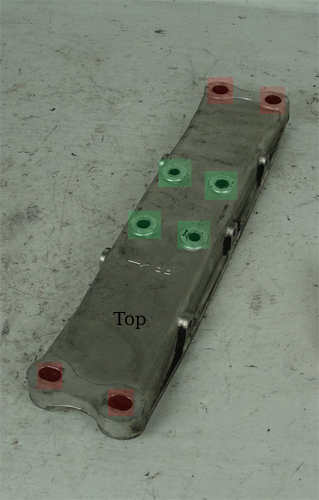

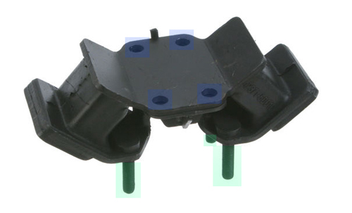

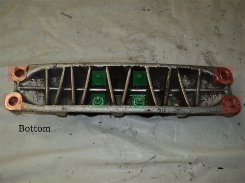

Simple aid to help trans mount R/R
Blue is connected to trans (4 bolts)
Green is mount to bracket (4 nuts)
Red is connected to chassis (4 bolts)
The colors correspond with location on the bracket. If you can't figure this out... Highfive! good luck!
