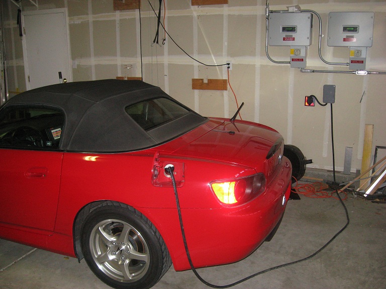

PD said it, it's the batteries that's the problem. i remember seeing a dude convert an s2000 to all electric and the whole rear end was purely batteries, among other complicated components.
http://s2kev.blogspot.com/
