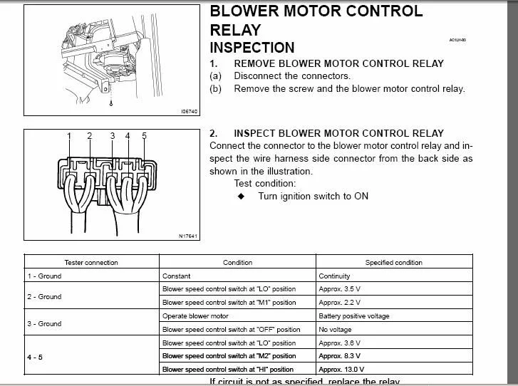

I am having issues with my fan on my 1998 LS400. Recently it started where the fan is stuck on low, even though I change the climate control fan speed to high. I did a AC system diag code, and it came back fine. I tested the voltage on the controller.
I tested the controller as specified in this document:
http://forum.ih8mud.com/attachment.p...1&d=1226121968
The voltage doesn't change from Pin 2 to ground when I change the blower speed control.
Also from pin 4-5 when the blower speed changes the voltage doesn't change.
Does anyone have any ideas on how I can fix this. Since the voltage never changes when I change fan speeds I think it maybe it is not the controller but something in the climate control.
FYI Pins 1-2 go to the fan, pin 3 is ground, pin 4 changes the fan speed somehow, and pin 5 is the positive power to the fan.

I fixed the issue turns out the cell phone hookup in the trunk can actually toggle off the fan speed to low. I unplugged the unit and everything is happy.
