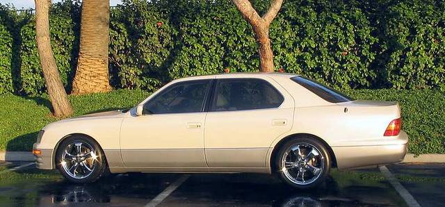

I went with H & R and it lowered it an average of 1.5" although I did not measure it before. The front dropped a bit more (you can see by the pic) than the rear. I think as far as ride quality goes it improved it. Before it was wishy washy. Now it is more responsive. There's still body roll, etc. which I will address with strut tower braces and other suspension components.
The local speed shop told me that if you lower it too much you may not be able to accurately adjust the alignment without buying/fabricating parts so I decided to shy away from Tanabe, etc.
Although I dropped the vehicle only 1.5" I do have to be careful on speed bump whereas before it was no problem.
Check out the pic.

Looks hot!

That looks GREAT!
I just got my wheels and tires on yesterday and now I am itching to do the suspension. Thanks for the info.
