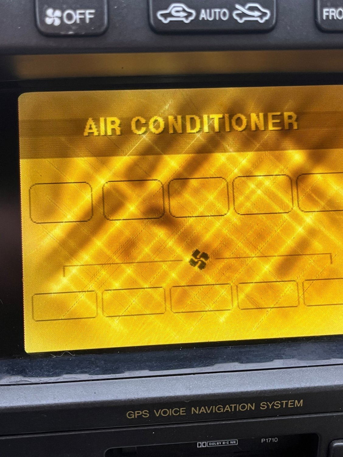

Default NO Climate controls all other things operating properly Radio,wipers, ETC on center
I have checked all fuses under the hood and under the drivers side console all are good!
this is my LCD display for my Climate control

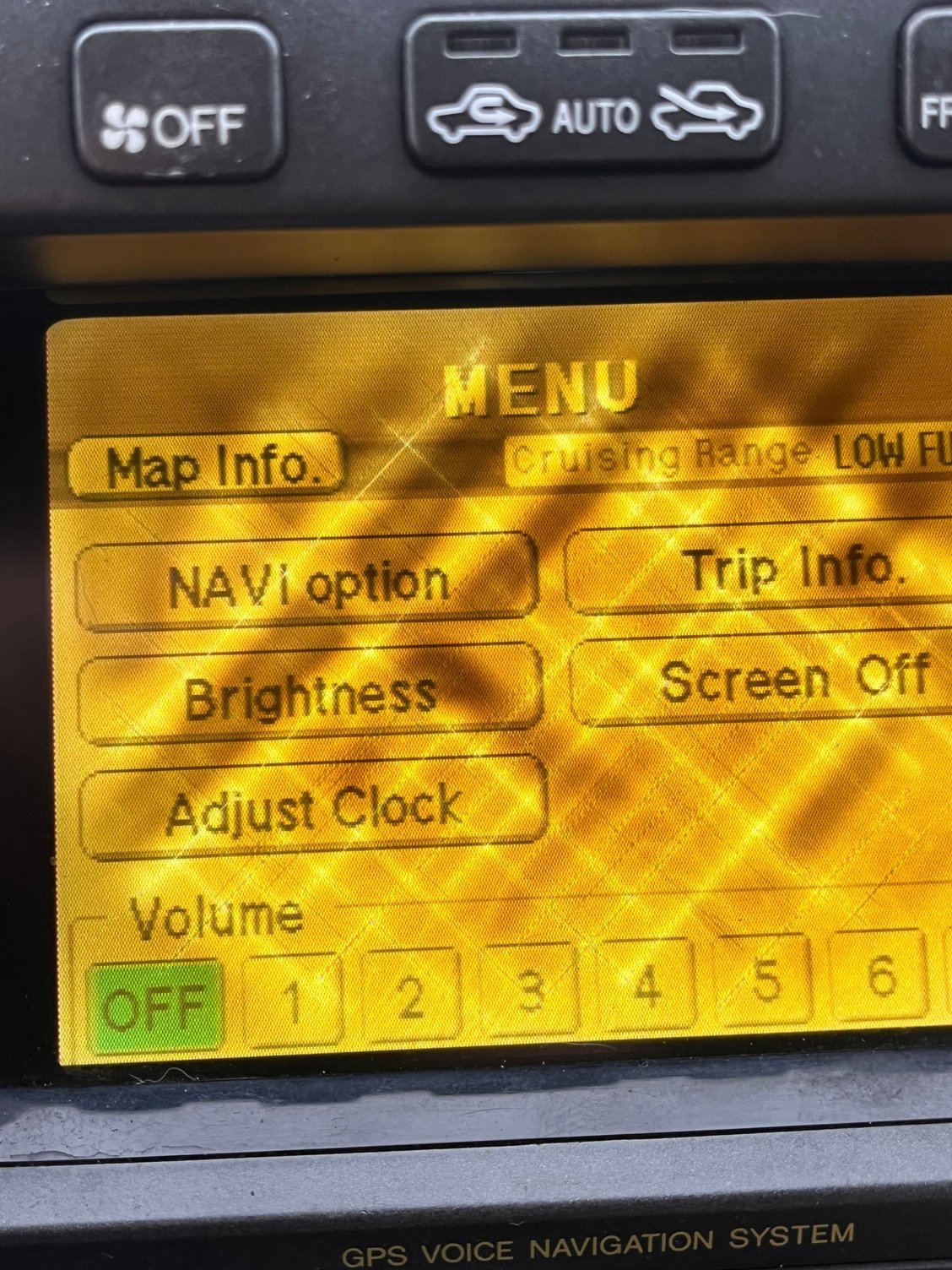

Same LCD for MENU
Same LCD for MENU

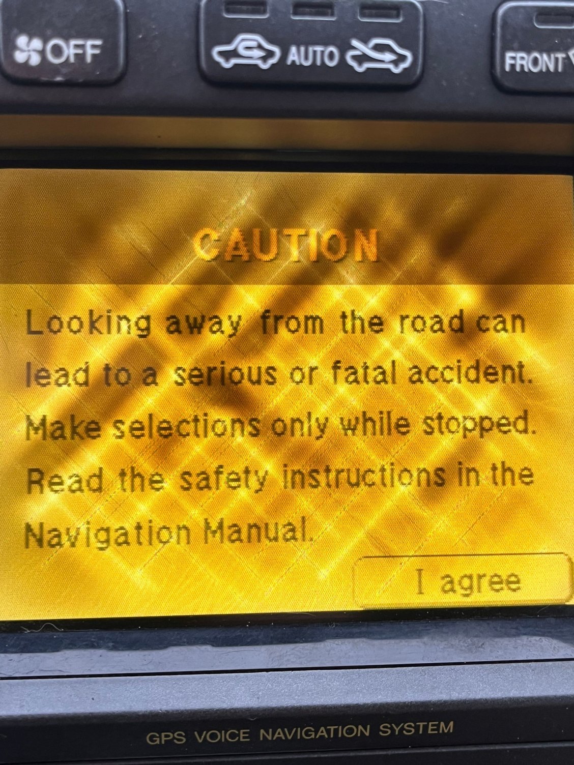

Same LCD for Navigation

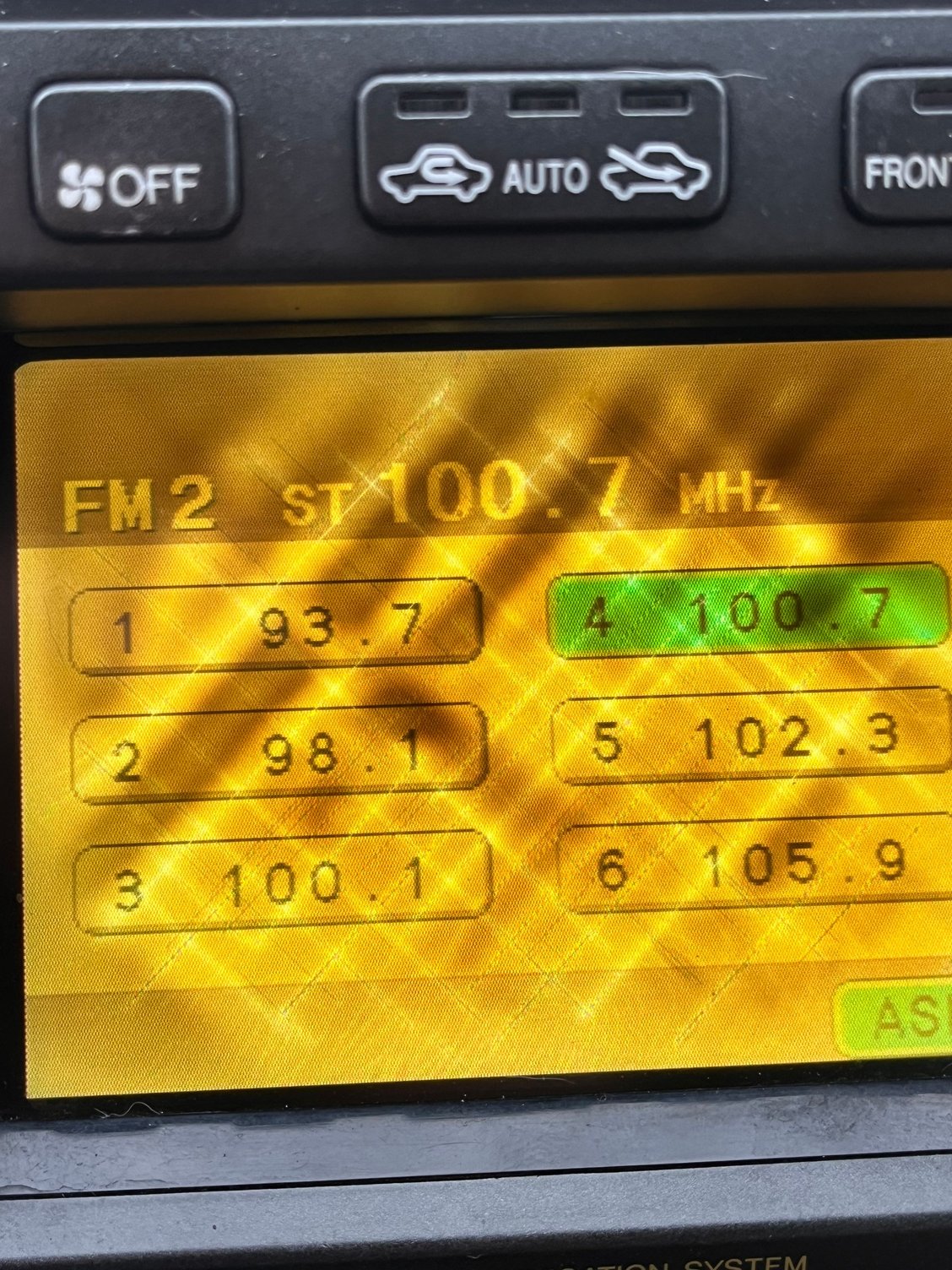

Same LCD for Radio Stations

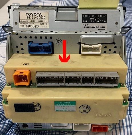

Same LCD for MENU
I think the climate control unit indicated by a red arrow is dead. I'm a guy who enjoys fixing electronics units for free but without analyzing the unit myself, I have no idea what component is needed to replace.
Incidentally, this photo is picked up from here.

As I have mentioned you, I have no idea to find out the failed part of the unit without analyzing it myself. Anyway at first, I'd start to check the current of the 7.5A fuse for A/C and find out which circuit is drawing the current which empties the battery. The fuse line is connected to the pin #1 of the connector Q. This line is connected to the A/C processors and it drives 5 motors and 1 solenoid using drivers. I imagine 1 or more of these are drawing the current.
