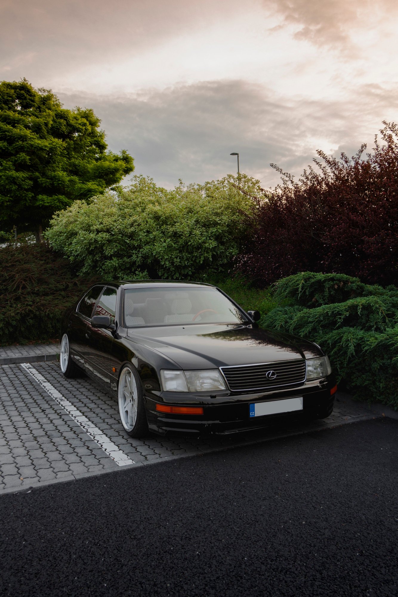

Hey guys, my corner ligth is lose and Im missing those plastic thingies that hold it in place, I saw someone mention them buy serial number but I forgot to save the thread, could someone help me find them so I dont have to replace the whole light?
Im new here so ill post my LS as well
