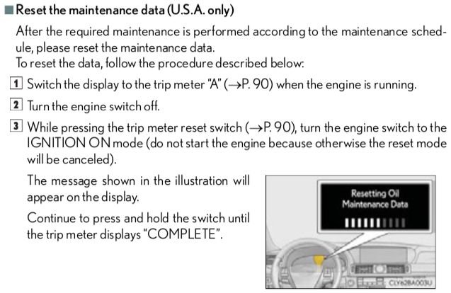

Does anyone know how to turn the maintenance light off above the speedo Its a 2013 ls

Hi Dan,
The reset procedure is found in the Maintenance section of your user's manual. This is on page 732 of my 2014 manual, and should work for your car.

Thanks so much, Worked great!
