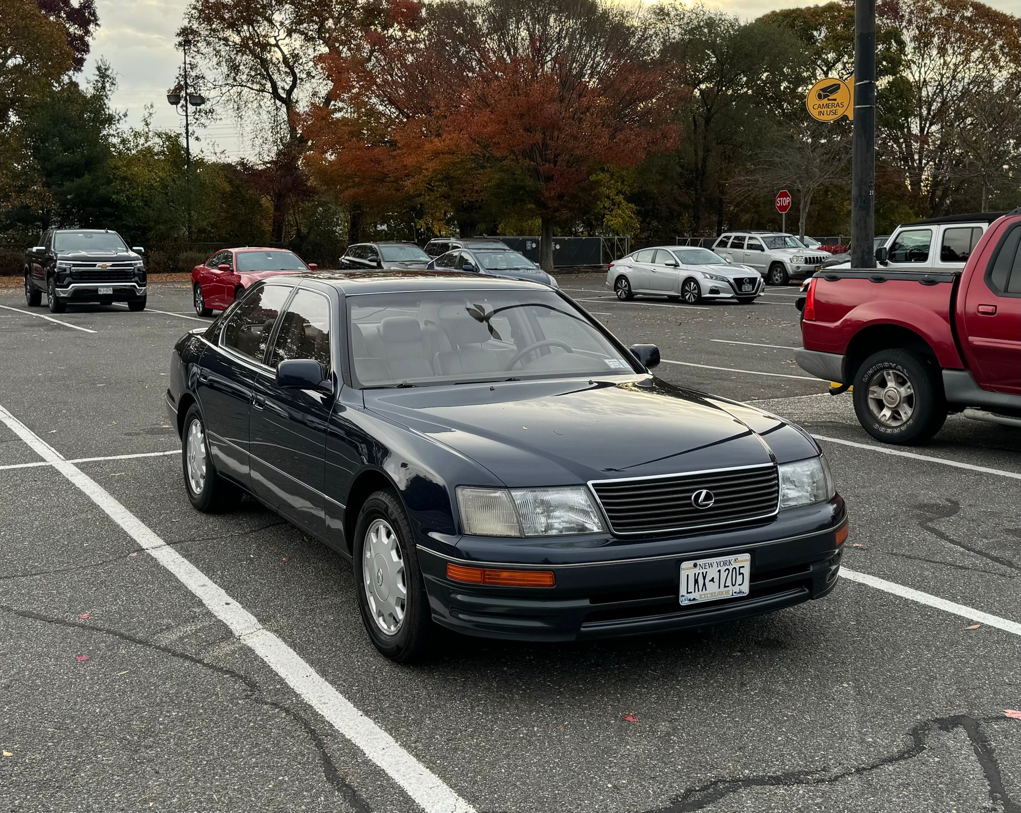

Alright just to wrap up this thread in case searched:
Pressure output of PS pump was fine.
Lexus found evidence that the reman Lexus rack was not installed completely correctly by Toyota, issues with installation of both inner and outer tie rods. The Toyota dealership despite having a near 5-star rating was ultimately extremely defensive and unhelpful. I will just pay the higher Lexus labor rate going forward (where I am $220/hr vs $180/hr at Toyota) and learned my lesson about trying to get cute going to Toyota for the cheaper labor rate, for things I cannot DIY. Also the stupidity on my part of introducing an additional party ie Toyota rather than have Lexus both (a) supply the part and (b) do the install.
Once the rack was reinstalled, it felt better. Not like factory new but a bit less stiff. Now my car seems slightly out of alignment because Toyota aligned the car with the rack not totally correctly installed, but this is an easier problem to fix.
For anyone searching this thread this was a lesson that for the Lexus reman rack, you may not get the factory original highly boosted steering feel. FWIW. But I’m in a better spot now, definitely less stiff and happy enough to move forward with other work I want to do to the car (mainly refreshing suspension)…glad to be back on the road…
