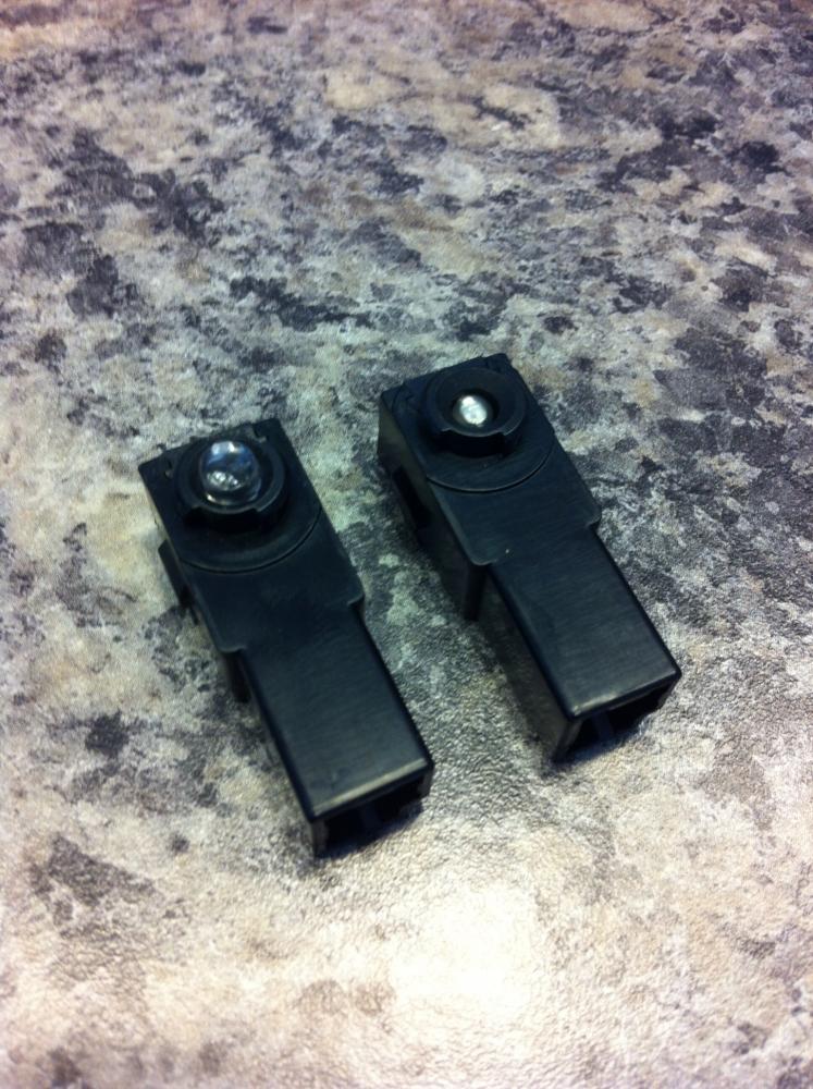

I noticed some people are swapping out there ugly green and amber led for nice white ones so I thought I would give it a shot. I've almost replaced every stock light in my 2007 ES350 and thought I would share some pics and info.

Here's a couple pictures.
