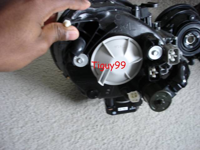

Sure!
Use 8mm or 5/16" Socket screw to turn the **** on the right side (this being the driver side lamp) or on the left if it were the passenger.
In simpler terms, the inner screw handles the vertical while the outer one closest to fender controls the horizontal. Does that make sense?

clockwise will raise or lower light?

I believe clockwise raises and counter clock does the opposite
