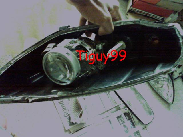

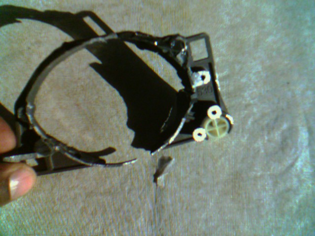

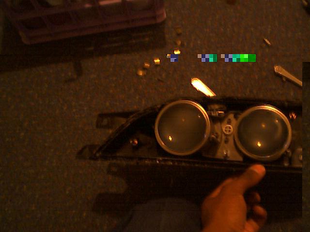

Maybe be means like a custom bracket to get it to fit the internal specs of the headlamp. I make those for SCs but for the ES300 2nd gen (92-96) You have to custom cut the internals to make room. Unless you totally plexi glass the whole thing in which you would have to recreate the Highbeam section as well since its all on one piece vs seperate pieces like the SC300/400 headlamps.... For example
ES300 internal piece...
SC300/400 internal piece
Same metal as the ES piece only this one was cut down to fit that Hella projector in there for the first retrofit this example headlight went through
See
So maybe he means these....
If so, I can help you
