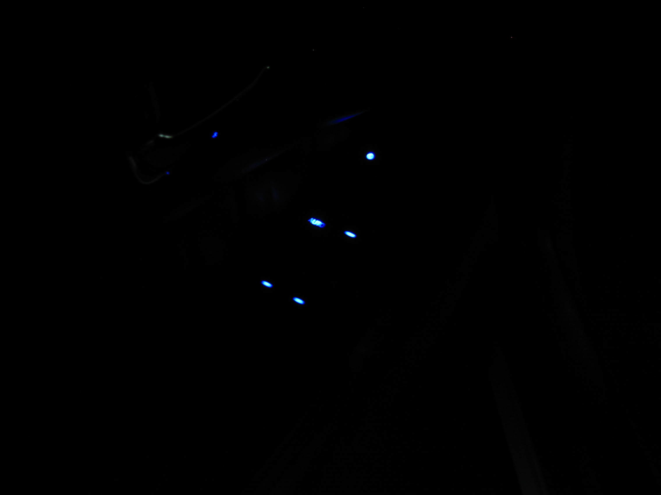

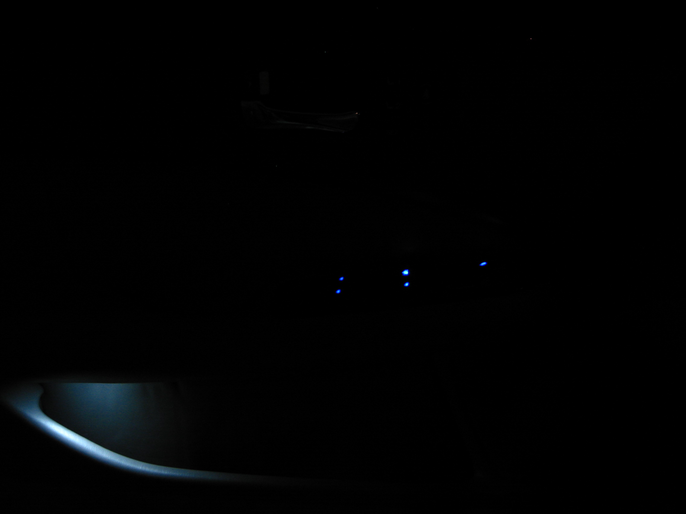

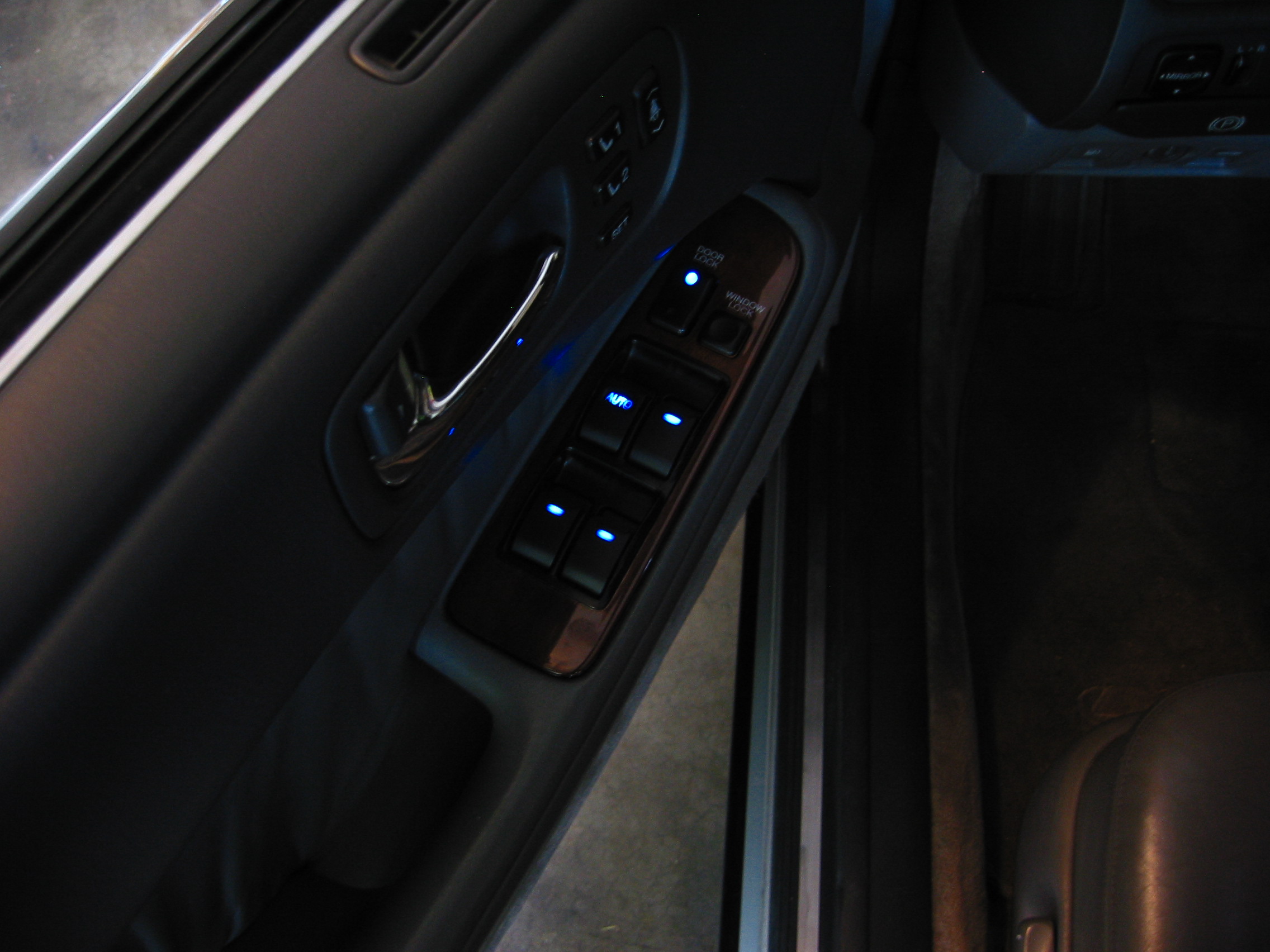

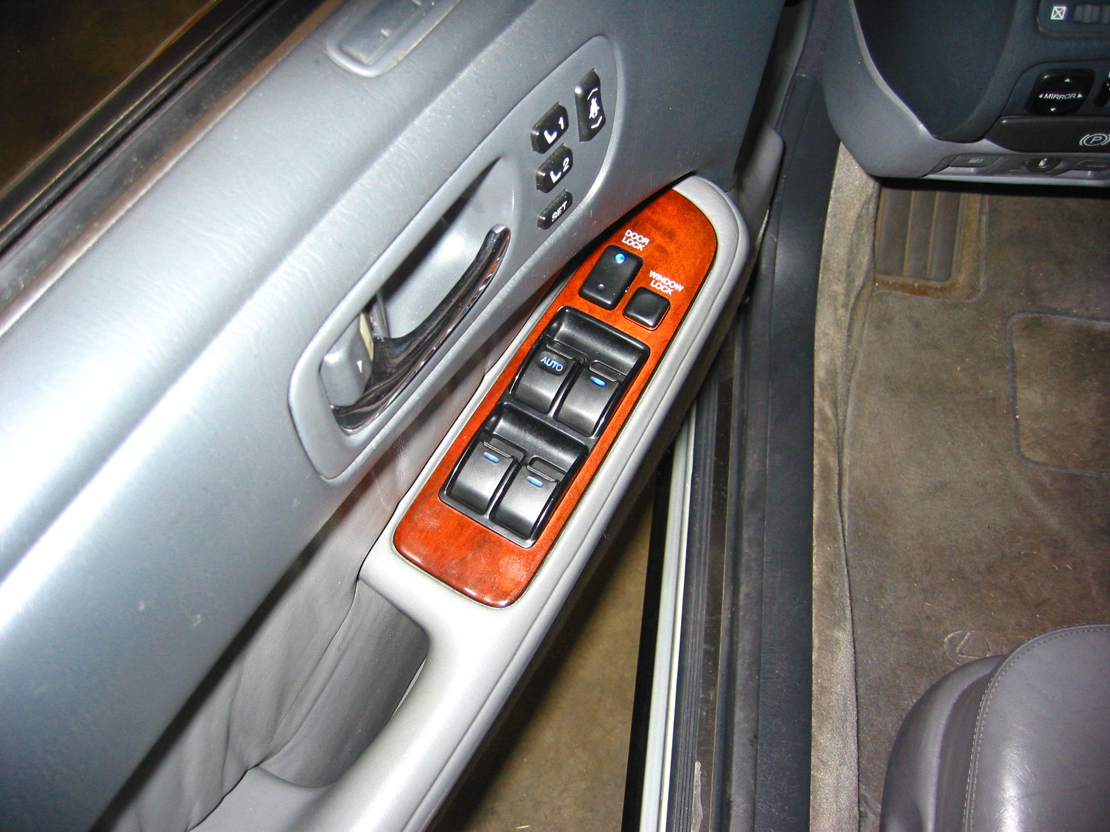

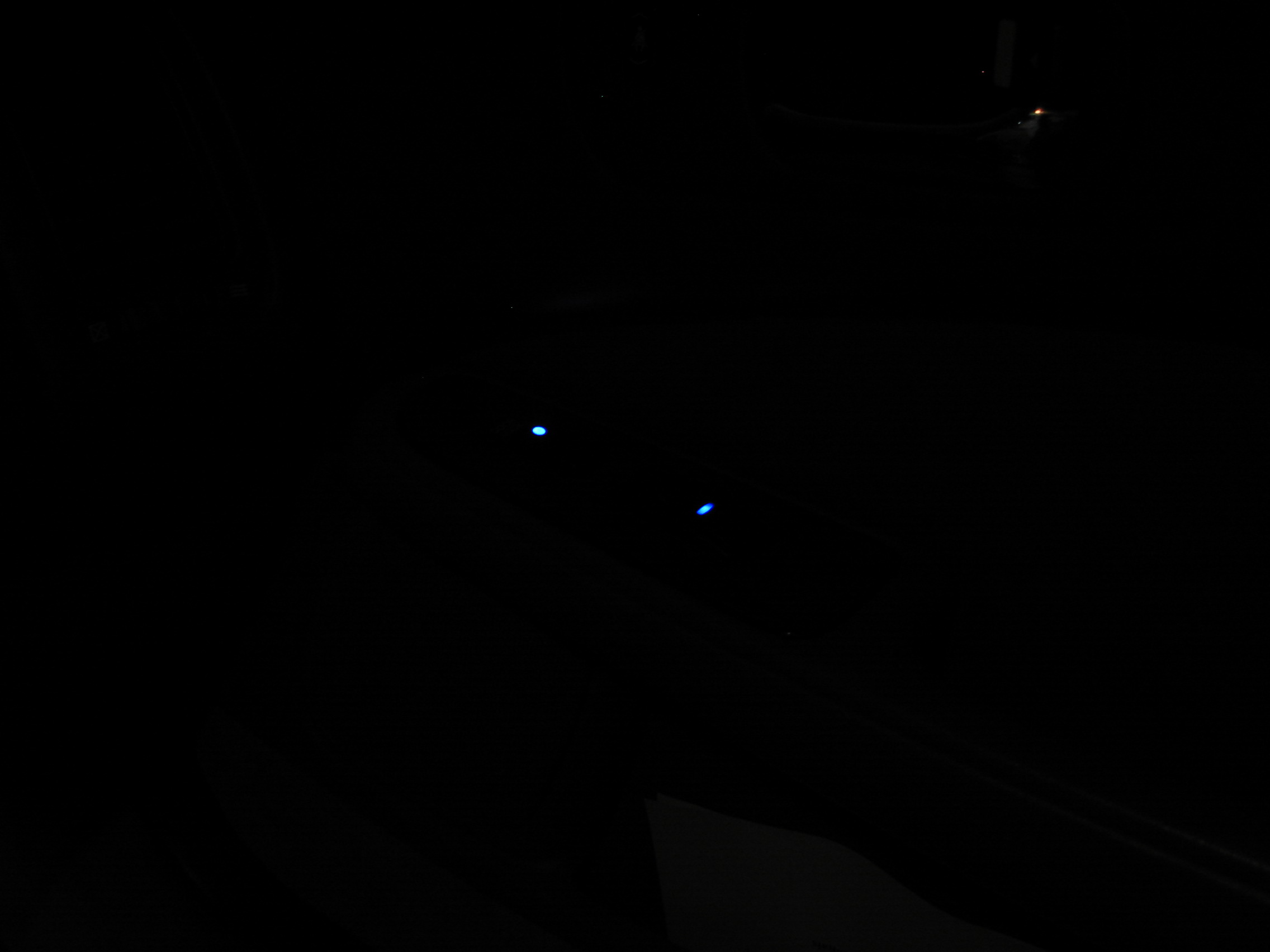

Hey guys, my LEDs i ordered of the internet FINALLY came in and i installed them and the new resistors to the window switches and door lock switches. It looks absolutely KILLER. Infact, i didnt even know the window switches in the rear lit up at all. Nor did i know that when you press the window lock botton it turns off the lights to all the window switches as to indicate they are now locked. Anway i replaced the VERY faint and dim green leds on the circuit boards with new brighter LEDs and new resistors. There was drilling needed to be done and whatenot but no too terribly difficult. Enough talk, here are the pics.
In the pictures the shade of blue looks very light and not very blue, but in real life they are a very deep blue and much deeper and better color blue than the 74 blue LEDs ive used for my ac and ignition lights. (You can even see these lights durring the day, i love it!)
