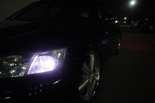

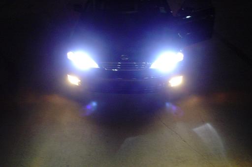

ok, so here they are...been looking around for something that would match my HIDs that are a bit violet in color...
I baught these LEDs for $5.99 a piece and look amazing on
they match almost perfect
look at them @ www.superbrightleds.com great internet service...recieved in 3 days
