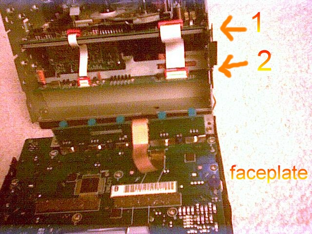

As you can see from the photo, the lexus radio is a 2.5 din radio. it has two full radio cages inside of it, as well as a half din space at the bottom. I will be removing both floors of the unit, and replacing one of the floors with the motherboard of the new aftermarket unit. getting the radio motherboard inside will be a fairly average job for me. but making it work with the stock faceplate is going to be the trick.

OK, as far as aftermarket head units, there will be two units i will be using. The mainboard (guts) unit will be an Alpine CDM-7861 flip face cd unit. The display screen will be from an older sony since the display will be easier to fit into the stock lexus faceplate. i am going to attempt to use the display from the lexus faceplate, but i am not expecting it to work, so i have aquired the sony for a backup because of it's similarity in height.
So as for the Vol control and the Stock LCD/ buttons you think you could get it all to work together ?? and a aftermarket changer als
the external volume can be used if i can get the Alpine board to accept an analog signal. the aftermarket changer can be used with any aftermarket headunit of the same type that is changer capable. if i use a alpine board, i can use an alpine changer for example.
This can be done to any radio of any brand, ford, chevy, lexus, ect.. since i am not using very many of the factory components. I am however having to use the factory faceplate and wire each individual button and light as well as any extra options the aftermarket unit may have, so it's no cakewalk by any means.
another problem is that unless i use a radio that uses analog rotary buttons for the bass and treble, i have to make one of the buttons on the face multipurpose.
That headunit looks like a non-cd one, so it looks like your going to have do some magic with the faceplate
Magic? hehe, david copperfield would be proud. i still haven't planned the escape hole for the cd yet. I don't even plan ahead on these kinds of projects because if i plan it, it won't go according to plan, and if i don't i can be creative. My dremel tool is exited about this as well
