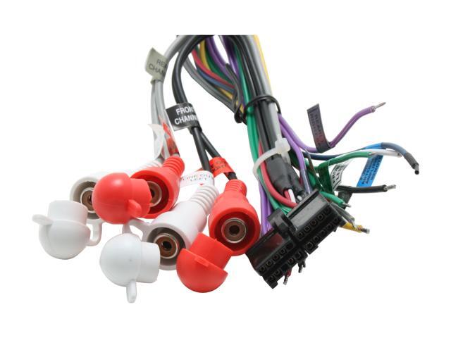

1. I’m assuming that your typical aftermarket head units will contain a similar plug:
Which will then hook up to this plug:
Which then hooks up to the OEM amp and then the other colored wires hook up to each other.
Am I somewhat right?

If there are ANY other accessories that you think I will need feel free to slap them here. So far I managed to pick out the harness (as shown in the picture): http://www.autotoys.com/x/cust/produ...productid=1133

1. I haven't seen an aftermarket HU without a plug like that. Some have the RCA outputs connected with short lines that don't unplug or they just may use RCA jacks in the rear of the unit.
2. You can bypass your OEM amp for the front, rear or both. It really depends on the aftermarket amp you are getting. And no, better speakers don't always require a better amp.
