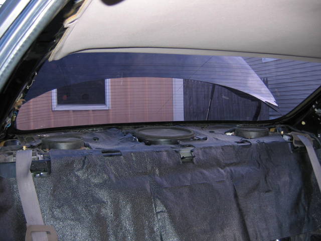

Here's a pic or 2 from the install.
Old sub.
New sub test (no baffle). You can see there is no way it was gonna fit without opening the hole.
Cuts made to begin opening the hole.
From the trunk.
That's all I have in my gallery. Lost the rest.
