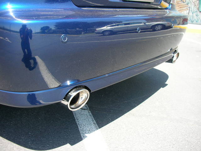

As far as driling holes, you need to pick a spot where the metal bumper behind the plastic does not interfere. A lot of spots in most cars. I had to trim the styrofoam bumper backing a bit for the hole clearance. That's easy as well.
Here's the kit I installed in a 2004 IS300. You can see I had the sensors painted separately to match. The kit even comes with a masking ring since you can't get paint on the inner circle of the sensor.
