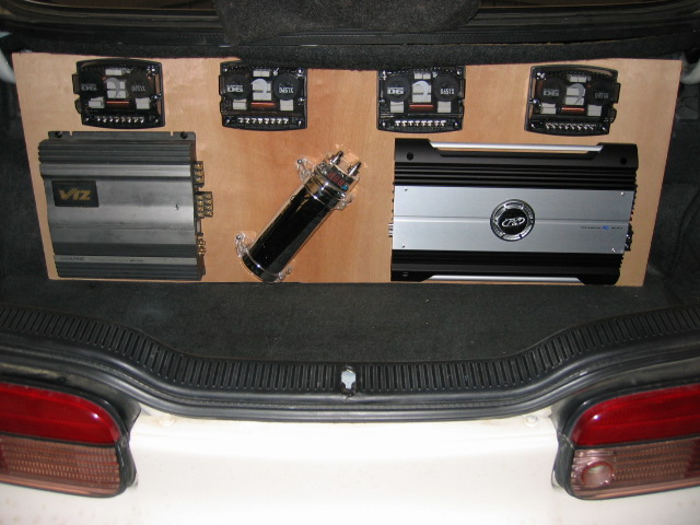

hey guys here's a pic of my work in progress. i need suggestions from you guys on what is the best way to support the rack the way i have it setup right now in my trunk.

well right now im making another piece to go over it to cover up the wires and everything except for covering the amps, cap, & crossovers. but i need to know what can i do to make it stay up and not tip over when i drive.

there are many ways of keeping the beauty plate up, one way is to build up the area around the amps with small wood blocks up to the height of your highest amp (or cap). The reason for doing this is so that you will have a place to drill/screw through the plate into the wood blocks. This will secure it really well, however, there will be a few screws exposed.
Another way is to pull out the entire enclosure and use "L" brackets and secure the enclosure to the beauty plate, then push it back in. You will need to secure the entire structure by bolting through the back some way. Maybe through the factory sub hole, arm rest hole etc.
Also consider industrial strength velcro...
