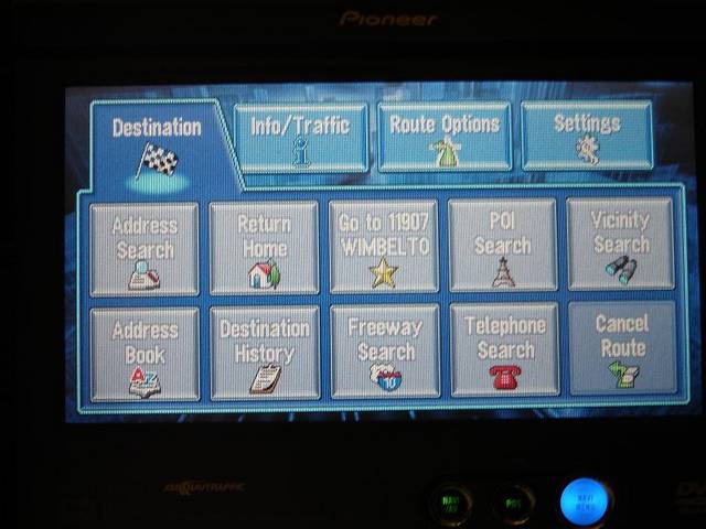

A picture of what its going in

Are u sure the 2000 ES300 came with Navi? Well it dosent matter anyway cause I ended up just working on it for a while Friday night and Saturday morning and I've got it in and working. I'll be sure to post some pics. But thanks for the help.

I took a quick picture after I did the install. Its not that great of a picture but I'll take some when I get home this afternoon.
