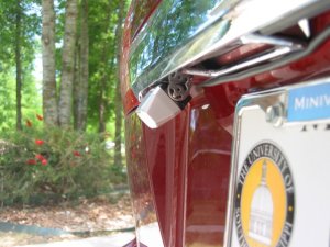

What camera did your installer order that's smaller and better than BEC103? BEC103 has been the smallest I could locate, with the Savv being slightly larger (pic below).
