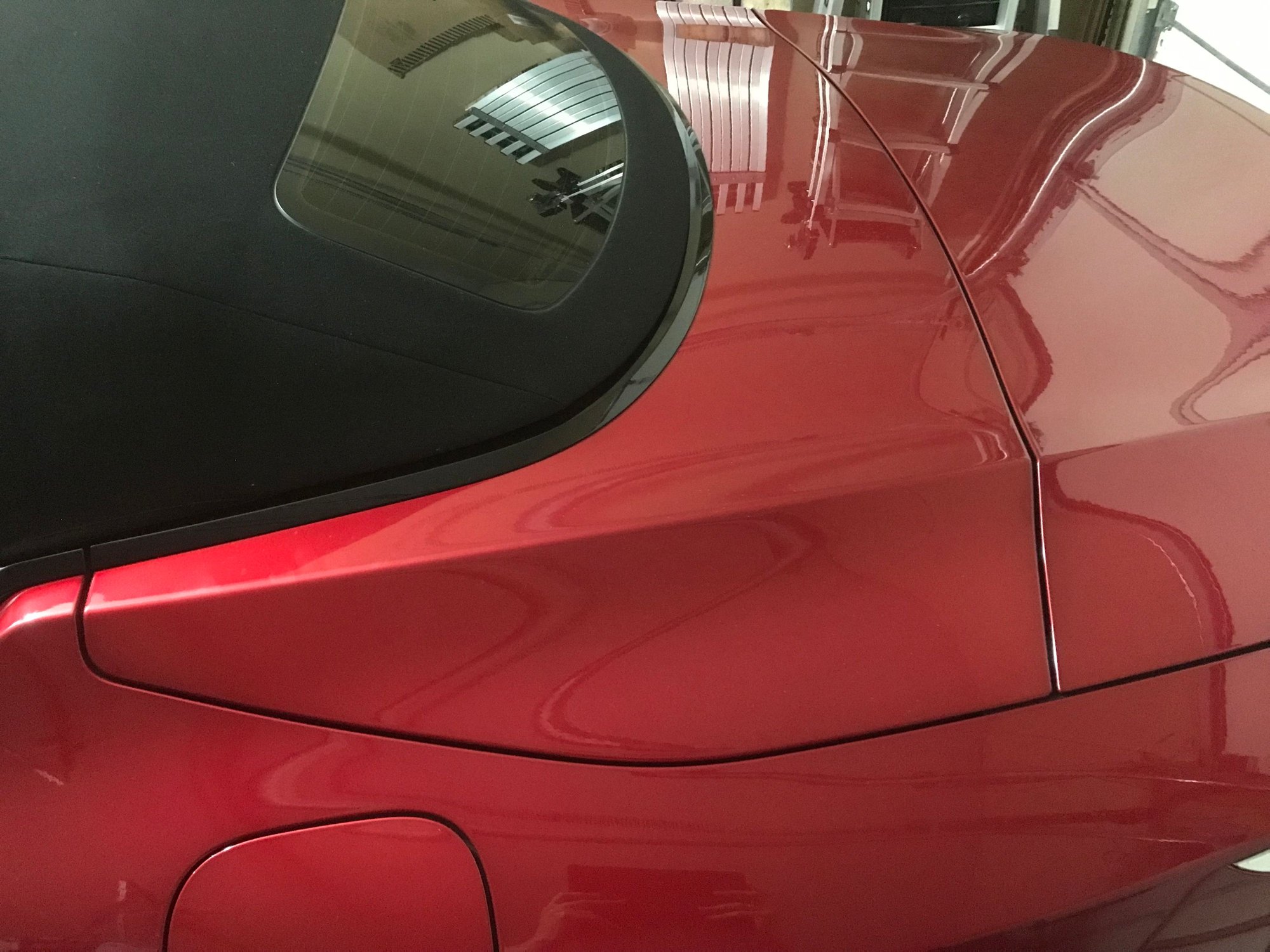

It looks like I found the root of the sound. Look at the picture below. The cover of top compartment when I push on the area right down after the panel bends so where in the middle it clicks. On an opposite side there is no sound. The clicking sound is kinda same as if you would push on a fuel cover, but not that loud. I will try to push it when top is down.
does any one know how to access that panel from inside. I may try to open top partially and look inside rised cover right? Any recommendations.

well now that you narrowed it down, i wouldnt start ripping things open yourself. Take it in and let them sort it out.
Can you also take a video showing what that sound... eruhh... sounds like?
