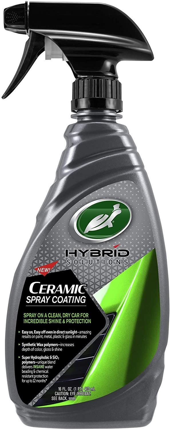

Just a thought... assuming you had your car ceramic coated on top of the ppf, the issue may be you've messed up the ceramic coating by getting it mixed with goo gone. If that's the case, then the issue is basically getting the ceramic coating OFF and hopefully the ppf underneath is fine.
1) Ceramic coating I put on top of the PPF wasn't a very long lasting product: Turtle Wax Hybrid Ceramic Coating Spray (attached)
2) How would I then remove that mixture? Do you think I could just buff it out? Can you even buff on PPF?
I sure hope the PPF isn't ruined, cuz then I'd have to re-wrap 90% of the front again (I did a full frontal wrap).
I'm still waiting for a response from Xpel to see if they can suggest something.
