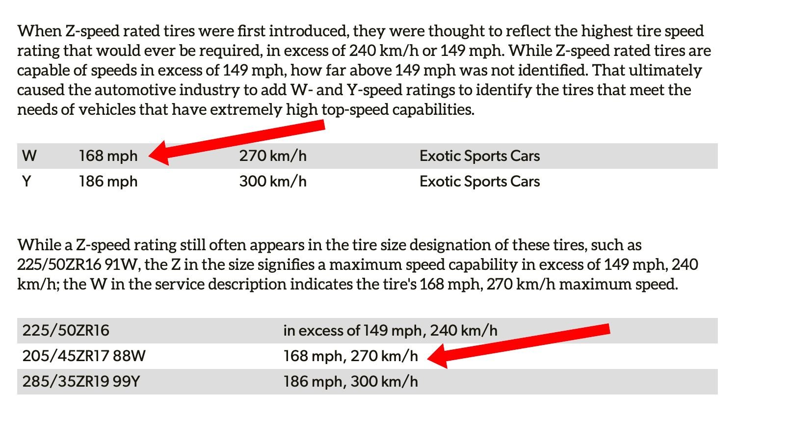

Originally Posted by DRGibbons
Can you explain how limiting the vehicle top speed helps the life span of the motor??? Doesn't really make sense to me . . . . . .
It's not about the engine - It's about the maximum speed the tires will handle safely
Remember this is the internet - You can't believe what most folks publish
Lou

Originally Posted by tmillLC500
try meditate on the fact that a 200 mph motor has more wear, heat, friction, and stress than a motor limited to 168....
OKAY. I meditated on it, though briefly , and I venture to say engine wear more closely relates to RPM, not MPH. An engine running at 7000 RPM @ 60 MPH will incur much more wear than one running at, say, 3500 RPM @ 150 MPH. . I was kinda janking your chain when I posed my question to your first email, but now that you doubled down I had to set the fact straight.
As Lou points out, the reason for limiting the speed is due primarily to tire safety. Tire safety is typically the limiting factor (weak link) on most high performance vehicles. Ask the Bugatti folks about that.
Lou
couldnt agree more ! maybe its time to consider publishing LIES to be an offense.
