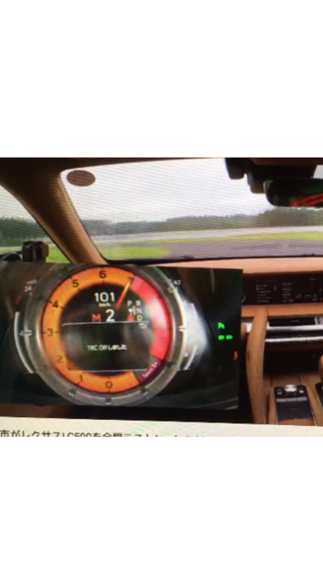

i'm continuing to discover unexpected features on this baby, some of which are detailed in related posts hereabouts, such as the borders on the speed limit signs changing to
yellow as you're speeding. y tube features a video of the tach turning orange before red as it hits redline, but i havent seen mine do this yet...

does my LC do this ?
