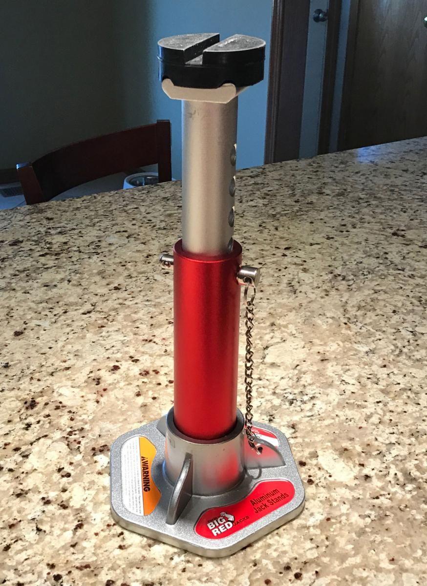

I have this exact setup (not my photo). Works perfectly for me. These pinch weld protector pucks fit this style aluminum stand and are made by Schwaben...
I have the same tower and rubber support.
Is the rubber a notched hockey puck? Not kidding !
Puertex

LOL - nope. Schwaben makes these specifically for their aluminum jack stands. Hockey pucks are too brittle. These have way more flex. I've seen pucks break while playing hockey (in cold weather)! Wouldn't trust a hockey puck to hold the weight of my car in any weather.

Originally Posted by Puertex
Cool...
The tower is nice. I have 4 of these. All aluminum.
Agree. They are super nice. Much prefer the flat base over the tripod or 4-leg designs (easier on the garage floor). And they're lower than most jack stands (10.75") which is great for a low vehicle like the LC. These are the protectors I use: https://www.ecstuning.com/b-schwaben...ors/3107838kt/
Clean both surfaces with alcohol and attach with 2-sided tape - and you won't have to worry about them falling off and rolling away.
BTW - from what I've read from professional mechanics, and also the floor jack instructions - it's not advisable to rely on 4 jack stands to hold the car up. 2-at-a-time only with the wheels chocked. The concern isn't the strength of the stands. It's the potential of the vehicle falling off the stands if pushed. I personally always leave the floor jack in place for added safety.
