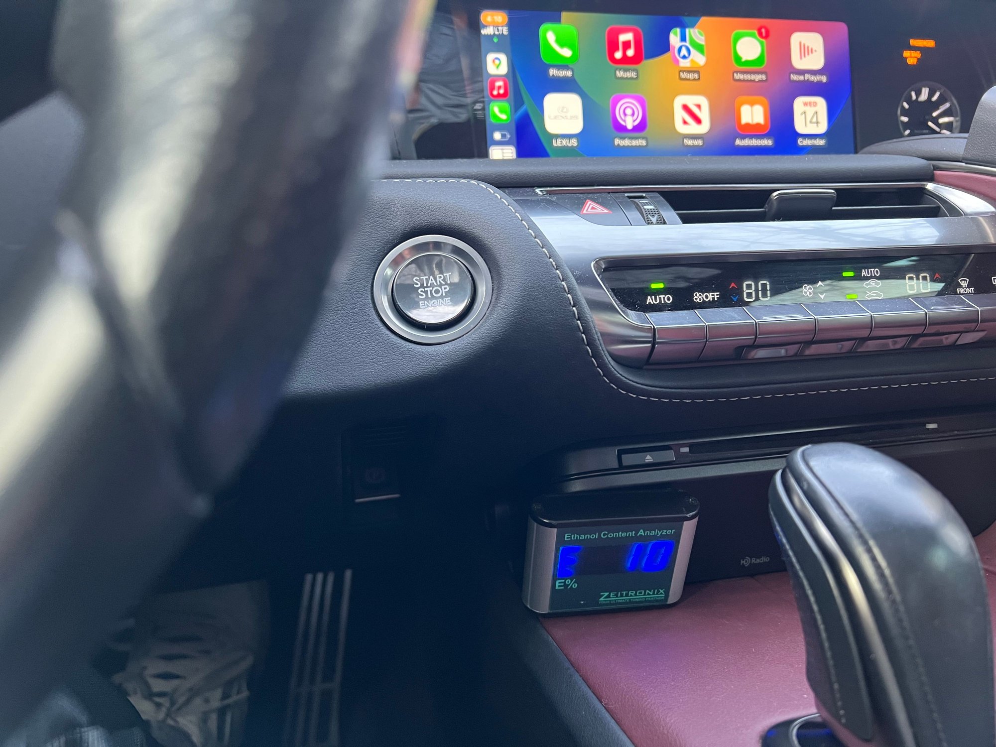

Ethanol content analyzer and fuel lines installed

Update: I’m officially running flex fuel in my LC as of today. I had a local shop install the zeitronix ECA pictured above along with e85 ready fuel lines.
Currently on a street tune provided by Loi remapping the ecu to be okay with e85 fuel. As of today it’s sitting at e56. After all the 91 octane is burned it should be closer to e80 and then Loi will dyno tune the car for optimal power output. We’re hoping for at least 420 whp but we will see. 🤞🏽
