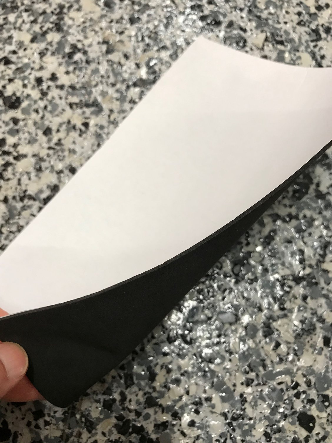

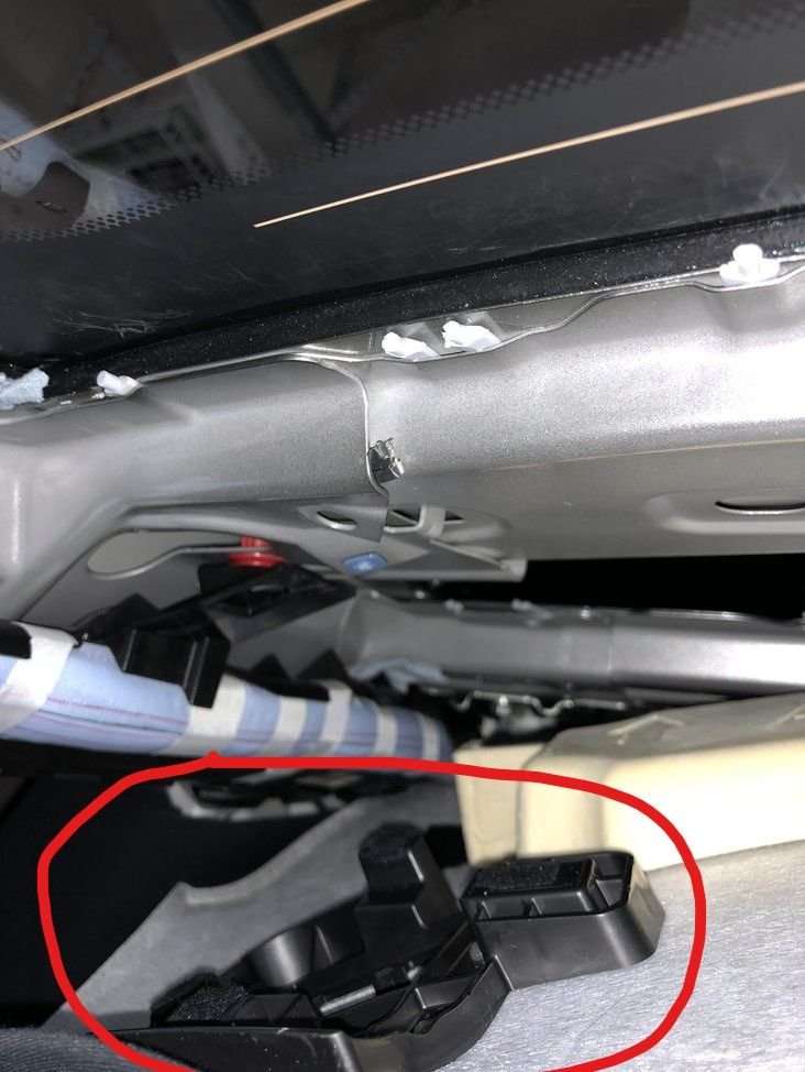

NOISE SOLVED! As there are several potential noises that may appear to be the same/similar, I understand that their sources may differ. Having said that, I was finally able to isolate and fix the one in my car. From the beginning, the noise sounded like hard plastic rubbing gently against metal when driving on anything but a perfectly flat road surface. The noise stopped when pressing gently upwards on the ceiling liner but returned after 15-30 minutes. If your car demonstrates the same type of noise (coming from the upper rear ceiling liner area) then this remedy could work for you. There are several molded plastic pieces (highlighted in red) that are part of the liner frame (as pictured). Those pieces all have small felt pads to prevent the plastic from ''squeaking'' against the metal roof frame. It appears that there is more area that actually comes in contact with the metal than only the felt pad areas. So I cut several pieces of thin foam sheets with adhesive backing and stuck them over all of the molded plastic pieces to cover a much wider area than the felt pads alone did. The perceived rubbing/rattle/cracking noise has now dissapeared.
