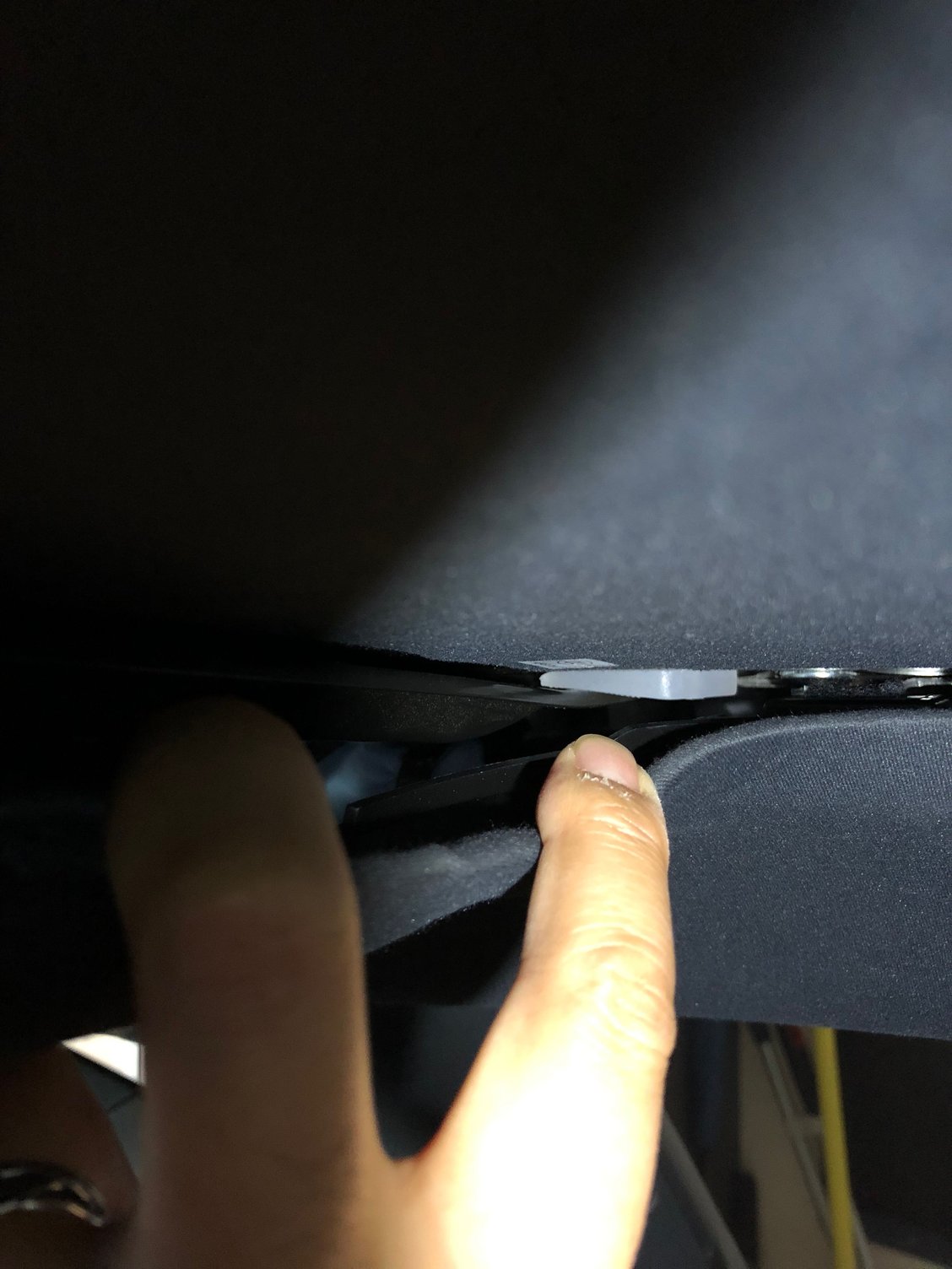

rattle #3.
This may only be relevant to those with sport package with glass roof.
This is the brace in question.
When driving over uneven road surface, this very pliable brace would flex and make a clicking sound
I ordered a furnature/table wedge as below
I had to trim the thinner side of the wedge to make it shorter and was able to push it into a space at the far edge where the brace meets the B pillar.
Don't worry about pulling down on the headliner, it is held by some velcro and will flex back to original position.
The wedge is far enough laterally so it will not interfere with the track for the sun shade.
ALL DONE!! finally enjoying what I expected a Lexus should be..................

Originally Posted by doclin
Furthermore, I felt like the foam padding may also be a source of noise.
So I added a thin t shirt to cover those areas. You can also see some of the fork spacers below
Rattle #2 SOLVED
will post #3 solution later tonight. Family event now.
take care.
Was it easy to pull the headliner down/off? Could you post some high level steps?
rattle #3.

Originally Posted by missedapex
Does anyone know how to pull the headliner down without creasing it or breaking the clips?
The headliner is quite sturdy. I must have pull it down more than 10x and still looks great.
It has been 1k miles since last update. NO rattle !!!!!!!
Remove the coat hanger on both side
then there are 3 clips that will detach easily when pulling the ehadliner downward. one is center and the other 2 are on each side as shown below
the headliner is fitted to the other liner to the side. The liners will separate apart and will fit right back easily
Here is the clip in green
As you can see....No crease despite my multiple repair trials...
