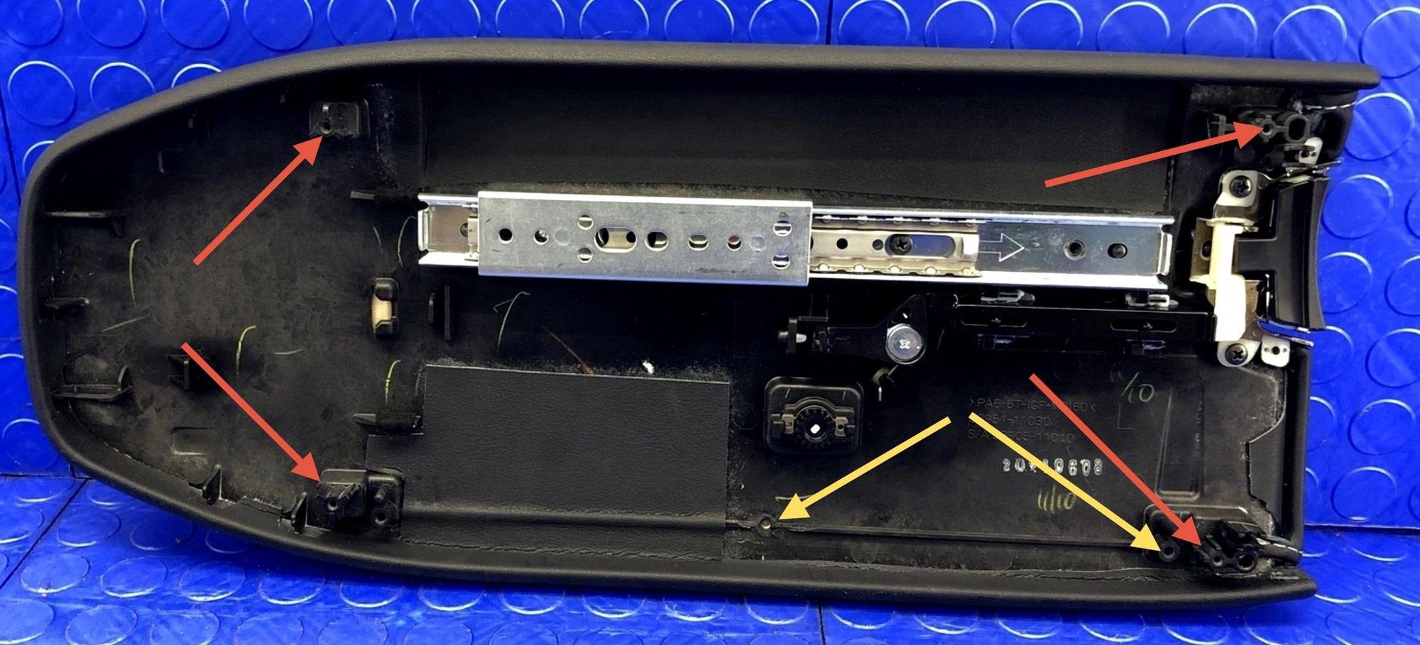

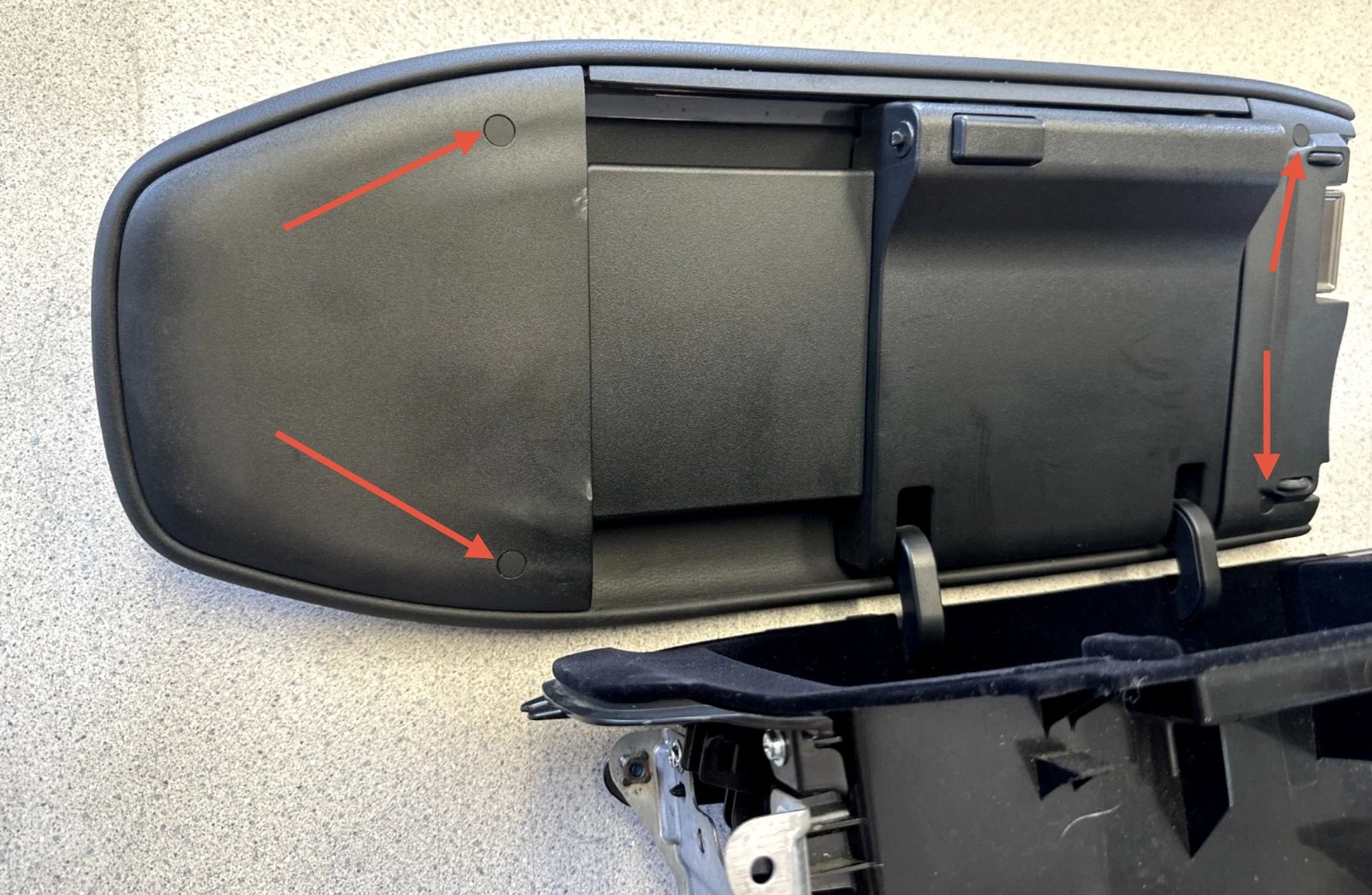

If I’m following that correctly, you’re trying to remove the center console pad cover assembly from the hinge.
It looks like you need to remove the four small caps to access the red screws, which will let you open the cover and give you access to the yellow screws for the hinge.
